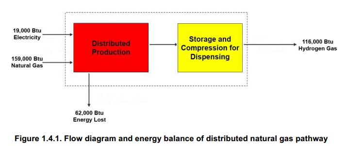

    so you agree we are not going to get that 70 or 80 mpge car that some of those old graphs were assuming. For the rest of this let's use 65mpge which is possible but probably high, and 55 mpg for the gen IV prius to be released around the same time and 100 mpge for an average plug-in (goes from 84mpge for mercedes b-cell -124 for i3, with the next gen volt likely around 100).
    Well we have this neat new nrel report where we use 5.7 kwh of electricity to produce and compress hydrogen for distributed natural gas, given a better than toyota conversion rate of 50% conversion and 73% efficient on natural gas without the electricity we get 59% well to wheel natural gas to compressed hydrogen. Yep first assumption is much more efficient than we expect for distributed production, centralized production is even worse when transportation is accounted for. We can multiply out 59% x 65 mpge = 38.35 well to wheel mpge. For that gen IV prius lets use the charts 84% x 55 mpg = 46.2 or 20% more efficient well to wheels. How about using US average 42% ccgt electricity natural gas to the wall 42%x100 mpg = 42 mpge well to wheel or about 10% more efficient on natural gas. But wait there is more people are choosing renewables to run their plug-ins and plug-ins are much more efficient than fcv on renewable electricity. That was really the biggest dishonest part assuming plug-ins and fuel cells would not use partial electricity as their feedstocks. So hype that with today's mpg estimates for future prius and mirai seem to show a much different picture. I don't think I even need to go into how bad their ice description is.
    Look they released that chart when they were trying to sell governments for subsidies for fuel cells, you expect a little exageration, but the chart was well beyond any real possibilities. Now that real numbers are coming out can't we just flush it and stop the hype that hydrogen is so much more efficient than plug-ins? I mean toyota should at least admit they need some breakthroughs to catch up to plug-in efficiency with hydrogen. Sure they may get there, but fuel cells are less efficient not more efficient than plug-ins ATBE. That NREL report is assuming 15% penetration of 10,000 psi hydrogen with stations built to service 300 fcv/day, lower penetration means less efficiency.

    The chart is accurate. My previous post addressed the Tank-to-Wheels of FCV 59% claim under Japanese cycle, which it compared Prius and BEV under the same cycle.
    Toyota used Well-to-Tank as 65% for 10,000 psi (67% for 5,000 psi). This is the same as what's used in the most recent NREL report, if you divide output by input (see below).

    UCS probably used the latest technology to be deployed in 2015. This DOE document describes 79% efficiency (see below). This is the recent breakthrough that wasn't in NREL 2013 report. It should when they do another update of the report.
