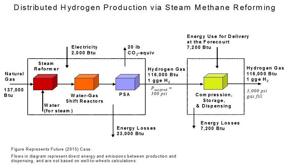

    That DOE document appears to have been written 10 years ago as a fantasy plan for what might have been achieved by now. Their crystal ball failed them. The NREL study from last year documents present reality as things actually are.
    Your DOE doc says:

    It also contains this in the notes, "Cost, resource requirements, energy requirements, all fuel and feedstock energy contents, and efficiency values for the Future (2015) case is from the H2A model cases modified to reflect the Department of Energy’s Hydrogen Fuel Cells, and Infrastructure Technologies Program 2015 cost goals as of November 2005."
    It is a document based on the assumption that 10 year goals have been met. There is no analysis of that likely hood. Plus, it is also only compressing the hydrogen to 5000psi as an assumption.

    First on the factual matter of whether toyota's chart is factual today we check the notes. The old chart was projecting for breakthroughs that haven't really happened yet, your link says it is still in the lab. We in 2014 still don't have it yet, and who knows if it will ever get out of the lab. TO this they compare the installed base of ccgt, even at the time of the chart newer ccgt tech was able to go natural gas to the plug at 50% efficiency. We do have many ccgt plants running at higher efficiency than this today. In the lab its even higher.
    None of the 68 hydrogen stations planned or in operation by 2017 will use this future tech in the chart. Many plug-ins though run on more efficiently generated electricity. So no when you compare future tech with breakthroughs to yesterday's tech it is not accurate it is intentionally misleading.
    As for car efficiency you may be right the hybrid and fuel cell were tested on the same test, but it seemed to imply the BEV was tested on EPA. I really don't know, but efficiency in a percentage is really something made to confuse, and all cars need to be tested on the same test, not two on a easy one and one on a realistic one, which appears to be what toyota did in the chart there.
    Do you still think it represents the state of the art today or the likely future?

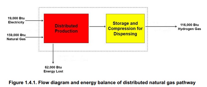

    As to what the doe projected it was it was 137,000 btus of natural gas, 2000 btus of electricity, and 7200 btus of other, which I can only guess is electricity because that is what we use to run compressors and chillers. To get to 79% efficiency you can't use toyota's 39% efficiency of natural gas to electricy, that gives you 72%. In fact going up to 875 bars and chilling the hydrogen from 350 bar as NREL has done for a station that actually has to fill 10,000 psi cars fast, probably takes that missing 9800 btus of electricity, which if generated as inefficiently as toyota says it is is an additional 25,000 btus of natural gas. Pop that sucker in there (NRELs electricity for reforming and cooling, DOEs future natural gas SMR, toyota's efficiency for electricity) and we get 62.5% efficiency, not far from the 59% I posted.
    If we are using in the lab for hydrogen stations why not batteries where the lab has 400 wh/kg versus 240 wh/kg in the most dense current car? I'm sure the toyota chart was written when state of the art was 150wh/kg cells. You can't comare technologies with one using future in the lab, versus one that is using past tech.
    The biggest misdirection of the chart of course as noted is that they assume it will be all natural gas, and not electricity. Its running on other non-fossil electriicty (wind, solar, etc) where plug-ins really get a lot more efficient than fcv. So yes if you use renewable electricity in compressing and chilling that hydrogen the process gets more efficient, but couldn't we also use it in the plug-in car?
    Again the lab stuff is possible with breakthroughs. I am not sure if we get there or not. With natural gas electrical technology though we have things that blow away that chart running in the field.
    For Japan though you won't see this chart its all about electricity, but the newer NREL report points to promising coal to hydrogen with sequestration, and DOE says this is probably cheapest in a new IGCC coal plant.

    If you read the 2013 NREL report on what's updated, H2 production efficiency was not one of them. They are still using the same number from the 2001 report. The information must be outdate.
    UCS report dated 9/2014 said:
    The power plant efficiencies reflect the current mix of natural gas power plants (80 percent efficient combined-cycle generation units).
    If you use electriicty at 100% though its much better, its 74% using NRELs 19000 btus of electiricty. This is something to shoot for in the future, and could be renewable. There is little pressure to make these high compression hydrogen compressors more efficient as the cost of electricity for compression adds little to the cost of the hydrogen. Then again if you are using electricty at 100% would you have to use that figure for bevs also, or increase it from 39%?
    I believe UCS means 80% of natural gas plants power comes from combined cycle plants with the balance as single cycle steam or ocgt. The 42% I gave you for the chart is the eia's heat rate for ccgt (2011) adjusted for grid loss. If you use the 80% figure it would probably drop to 40% as the other natural gas is less efficient, but at least on the texas grid rarely used for plug-ins. All natural gas steam are old technology, and many will get retired long before fcv take off. Replacing a 40% efficient steam with a 59% efficient ccgt not only cuts fuel use by more than 30% but allows the plant to cycle with renewables and reduces the needs for ocgt. 35% natural gas ocgt is still needed to complement coal plants, but coal plants are being shut down much faster than they are being built in the US. Calfifornia can only build new ccgt and should be retiring old natural gas steam, their mix in 2013 was down to 4% coal, so their natural gas + coal efficiency should be higher than 42% today given the marginal wind and other non-fossil fuels in the marginal mix.
    You still are trying to compare technology that hasn't made it out of the lab yet for hydrogen to older natural gas technology that has stopped being built. Can you give a rationalization for that? At less than $3/gallon gasoline what do you think is more likely in the next decade? That we use tax payer dollars to build thousands t of hydrogen stations across the country, or that we continue replacing aging natural gas and coal plants with today's technology natural gas, wind, and solar? I only mean to inform what today's tech can do and the bad assumptions on that chart. You can't get to the hydrogen efficiency promised without having much higher electrical efficiency.

    It's not out of date. In fact the 89% efficiency in the 2001 paper is the high end. Likely due to the assumption that the steam will be put to use somewhere else, though it is hard in imagine how much that would be for an onsite reformer(hot water for the restrooms).
    This 2012 paper states that current commercial SMR plants range from 80% to 90%. It looks into the possible maximum efficiency possible for the process. Theoretically, the process can get to 93.8%, but the realistic limit is 90.7%. The industry has been doing this for over seven decades. The chances are that we have already wrung out all the efficiency we could from the process. I got a condensing boiler and water heater. Getting the extra heat from the burnt NG in these units do means consuming more electricity with a blower.
    http://www.h2alliance.com/pdf/ie3002843.pdf

    DOE didn't meet its 2010 goal.
    The top efficient SMR to hydrogen plants use the waste heat to generate electricity and heat the feedstocks in the refinery. These are massive units, but we need a lot of hydrogen to remove sulfur from oil prioducts. We can definitely build huge plants to do this, but then you need to build pipelines and/or truck the hydrogen. The NREL estimate for natural gas at one of these much much smaller average 1500 kg h2/day was 73%. Those in the field are lower, and we need a lot more fuel cell vehicles on the road before.
    The difference between that future possible DOE and NREL is only 22,000 btus of natural gas, even those most efficient ones only use 30,000 btus less, or about $0.12/kg of hydrogen The key needed is to drop the cost of the equipment and its maintenance not to make it more efficient at this much smaller size. Equipment and maintenance costs add much more to hydrogen costs. The fuel cell lobby can do hand waiving and claim even more will be made renewable which won't be as expensive.
    Now looking out 20 years, say we have some breakthroughs and we are using that 34 kwh of natural gas and 5.6 kwh of renewable electricity. If we think that far out it is highly possible. Then the ghg footprint of a 70 m/kg fcv would be about 105 g/mile carbon dioxide equiv. This is very good, less than half of the gen III prius.
