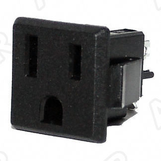

    It wasn't in a prius, but the best I've seen had the inverter mounted in an underseat/out of view location (to facilitate a short cable run for the DC side) and the 120v output was remoted off to a panel-mount NEMA 5-15 socket like this one:
    So in normal operation you never saw or heard the inverter at all.
    Good luck!
