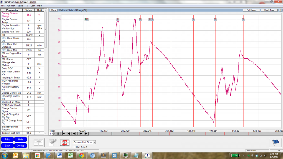

    I managed to get the MVCI up and running over the weekend. I'm pasting below a HV Battery data snapshot. Looks to me like the voltages and resistances are okay, but what about the Delta SOC? It stays pretty consistently around the 80% mark which I gather is way above the expected range.
    I also tried monitoring the min/max voltage as discussed here (Predictive battery failure analysis for the Prius Hybrid) and they seem to track pretty closely within 0.1–0.3V. I also drove around my neighborhood while recording the HV Battery output. One thing that stood out is that the SOC drops about 0.5% every 1-3 seconds or so, even while parked in "P". See the attached image: the first stair-stepping drop in SOC is while in D but with my foot on the brake, and the second stair-step drop is while in P.
    Any advice or suggestions greatly appreciated, thanks again to everyone.
    [HV Battery Live] System
    [Parameter] [Value] [Unit]
    Engine Coolant Temp 127 F
    Engine Revolution 0 rpm
    Vehicle Spd 0 MPH
    Engine Run Time 62 s
    +B 14.190 V
    DTC Clear Warm Up 255
    DTC Clear Run Distance 34821 mile
    DTC Clear Min 65535 min
    MIL on Engine Run Time 0 min
    MIL Status OFF
    Mileage after Malfunc 0 mile
    Battery State of Charge 49.0 %
    Delta SOC 77.5 %
    Batt Pack Current Val 1.08 A
    Inhaling Air Temp 82.4 F
    VMF Fan Motor Voltage 10.0 V
    Auxiliary Battery Vol 14.0 V
    Charge Control Val -7.0 KW
    Discharge Control Val 21.0 KW
    Cooling Fan Mode 3
    ECU Control Mode 0
    Charge Control Signal ON
    Equal Charg Out Rly Sig OFF
    EQTR Charge Perm Sig OFF
    Standby Blower Request OFF
    Temp of Batt TB1 109.9 F
    Temp of Batt TB2 115.9 F
    Temp of Batt TB3 106.9 F
    Battery Block Num 14
    Batt Block Minimum Vol 16.39 V
    Minimum Batt Block No 5
    Batt Block Max Vol 16.51 V
    Max Battery Block No 14
    Battery Block Vol -V01 16.48 V
    Battery Block Vol -V14 16.47 V
    Battery Block Vol -V02 16.42 V
    Battery Block Vol -V03 16.43 V
    Battery Block Vol -V04 16.39 V
    Battery Block Vol -V05 16.45 V
    Battery Block Vol -V06 16.44 V
    Battery Block Vol -V07 16.42 V
    Battery Block Vol -V08 16.41 V
    Battery Block Vol -V09 16.45 V
    Battery Block Vol -V10 16.43 V
    Battery Block Vol -V11 16.42 V
    Battery Block Vol -V12 16.45 V
    Battery Block Vol -V13 16.44 V
    Internal Resistance R01 0.026 ohm
    Internal Resistance R02 0.027 ohm
    Internal Resistance R03 0.027 ohm
    Internal Resistance R04 0.027 ohm
    Internal Resistance R05 0.027 ohm
    Internal Resistance R06 0.027 ohm
    Internal Resistance R07 0.027 ohm
    Internal Resistance R08 0.027 ohm
    Internal Resistance R09 0.026 ohm
    Internal Resistance R10 0.027 ohm
    Internal Resistance R11 0.027 ohm
    Internal Resistance R12 0.027 ohm
    Internal Resistance R13 0.026 ohm
    Internal Resistance R14 0.027 ohm
    Battery Low Time 0
    DC Inhibit Time 0
    Battery too High Time 0
    Hot Temperature Time 0
    Compliance Regulation OBD2
    Emission DTC Num 0
    The Stored DTC Num 0
    Calculate Load 0.0
    Throttle Position 16.0 %
    Complete Parts Monitor Avail
    Component Monitor CMPL Complete
    Component Monitor ENA Enable
