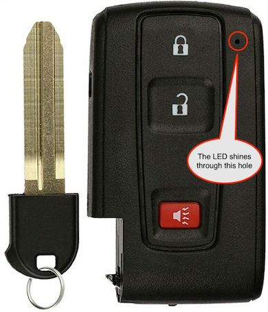

    not really. you can try cleaning the inside and making sure the battery is tight. generally speaking, if the red light flashes when you press a button, it is working
  9. qmanqman
    qmanqman Active Member
    Mar 29, 2020
    444
    153
    CO
    Where is this red light you speak of? If it's on the fob I've never noticed because I usually press it while its in my pocket.
  10. bisco
    115,446
    52,854
    yes, on the front corner, iirc
  11. dolj
    dolj Senior Member
    May 14, 2012
    8,645
    4,396
    Wellington, New Zealand
    You remember correctly. ;)(y)

    Thank you guys. I did find the light. On my fob the red light comes on when I push a button. On hers there is no light. What is the fix?
  13. bisco
    115,446
    52,854
    make sure battery polarization is correct, new battery, clean the contacts, replace the fob, in that order
  14. bisco
    115,446
    52,854
    try searching fob repair
