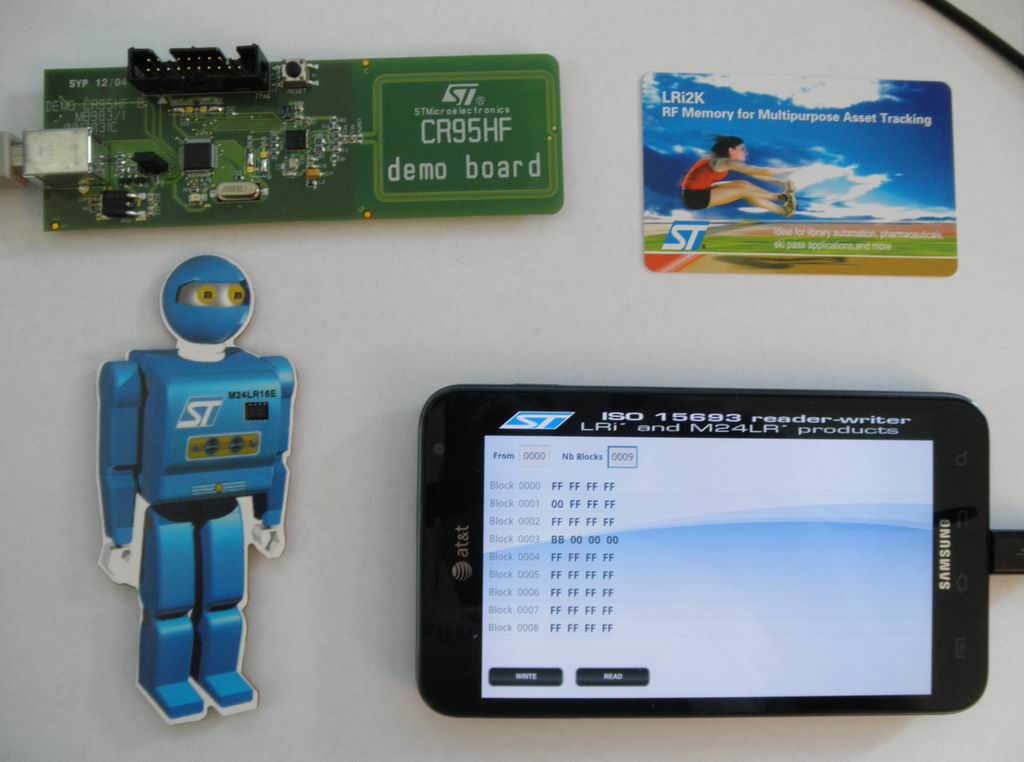

    Most dealers do not understand the technology. Some do and that video was excellent.
    The FOB uses inductive charging to charge a capacitor inside the FOB long enough for it to exchange keys with the car so the car will start.
    At work I have been giving demos on NFC (Near Field Communication) using my cell phone. The robot in this picture has a NFC chip that when close to the phone I can make the LED’s for eyes blink or write to registers in the robot. The robot only has a coil and capacitor. It is charged by the coil in my cell phone.

    Nebraska
    Nice....Galaxy Note?
  9. Judgeless
    Judgeless Senior Member
    Jun 30, 2009
    1,821
    257
    Cleveland, OH
    It is an amazing phone.
    5.3" 1280x800 display
    Dual Core Cortex A9 1.5GHz processor
    64GB SDXC card
    NFC, LTE (75Mb/s), WiFi a/b/g/n , BT
    It is higher res and more powerfull then many laptops from a few years ago.l
