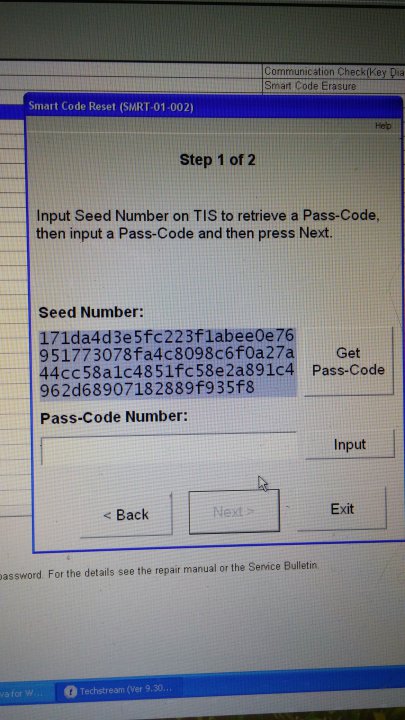

    Just yesterday morning I was able to register a used previously paired FOB that I purchased from ebay to my 2010 Prius.
    I can provide links and details later but to summarize.
    Installed Oracle VirtualBox and a 32bit Windows XP VM - free
    Order Cable with techstream from ebay - $25.99
    Order Used FOB from ebay - $80
    Order Pass Code from Sigmabit.eu (not needed if FOB not previously registered) $22.86
    My only mistake was not ordering another couple used FOB's from ebay and have 3 or 4 registered key.
    golfinbud, pfhyper and Chazz8 like this.

    If you are computer savvy the way 2DMxLST did it is very cheap and easy procedure once everything is installed, and you end up with Techstream which will pay for itself time and time again. If you are not good with computers you may find it frustrating because the documentation isn't very complete.
    Sigmabit.eu is in Europe so you have to do it early in the day in the US.
    (They provide passcode within minutes for seed codes so you can reset the smartkey system and use "used" fobs).
    Sigmabit.eu has cracked the algorithm Toyota uses so you don't need to be locksmith or work at dealer to get passcodes, you just have to Paypal them 20 euros for each code.
    Tips,
    1) Make sure fob battery is good (small LED should light when you press buttons).
    2) Make sure your laptop is plugged into the wall,
    3) Make sure car has a 12v charger attached and/or a very healthy 12v battery. If 12V drops too low or laptop goes off during the 16 minute waiting period you have to start over and pay another 20 euros.
    4) Drivers door must remain open, prop it open with a trashcan or something else. If it closes you have to start over.
    pfhyper likes this.

    Once you have those items in place and you retrieve your Seed Number and send it to Sigmabit.eu you are presented a dialog box that takes 16 minutes to finish, it has a count down. I am CST and Sigmabit is in the UK so I had to do it in the morning before work. From the time I ordered the Pass-Code to when I received it was ~15 minutes.

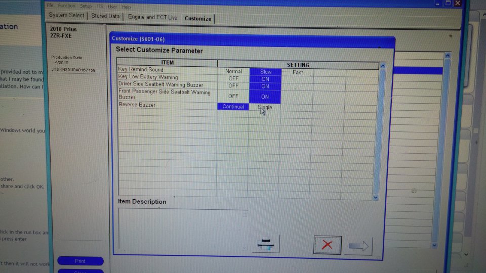

  13. 2DMaxLST
    2DMaxLST Junior Member
    Aug 22, 2014
    San Antonio, Texas
    And you can also do this: :)
