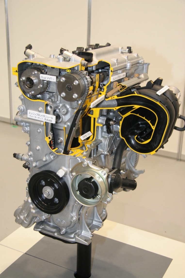

  15. Tideland Prius
    45,326
    16,559
    ok so I couldn't find any 1ZR-FE engine pics.
    Here are the 2ZR-FE pics for size comparison. For some reason, the bottom pic's squished so hopefully you can open a fullsize version

  17. Tideland Prius
    45,326
    16,559
    galaxee, any luck with those pics and the sneak peek? Do the dimensions seem reasonable?
  18. galaxee
    galaxee mostly benevolent
    Mar 14, 2005
    9,810
    471
    MD
    the 2zr replaces the 1zz... and it's 1.8l... ooh, that might be it.
    dimensions right, oil cap location right, engine shroud to dampen noise.
    but... it's not exactly dead-on the same. they could have done a bit of redesign for the prius.

  20. Tideland Prius
    45,326
    16,559
    well it was either the 1ZR or the 2ZR. I couldn't find a pic for the 1ZR so I gave the 2ZR. I'm sure the black engine cover makes it look slight bigger than it really is.
