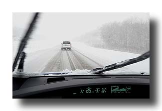

    13 Winters in MN driving a Prius. This was a memorable drive from last year...
    The key is simply taking it slow, just like you should with any vehicle. That combined with good all-season tires or snows, you'll be fine. Slow is especially nice with a Prius, since MPG rise from lower speeds.
    Climbing my local hill out of the valley where I live hasn't ever really much of a problem. We really only get the challenging snow (that wet & heavy stuff) in early Spring. By then, you'll have a feel for how hard to push the pedal.
