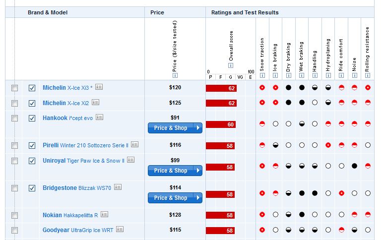

    I looked at Consumer Reports this evening. Your information appears to be wrong again, Proxy.
    While the Michelin Xi3 and Xi2 top CU's 'Winter Tire' category ratings for snow traction and ice braking, they bottom the ratings for wet and dry braking:
    CU's recommendation for this tire class:

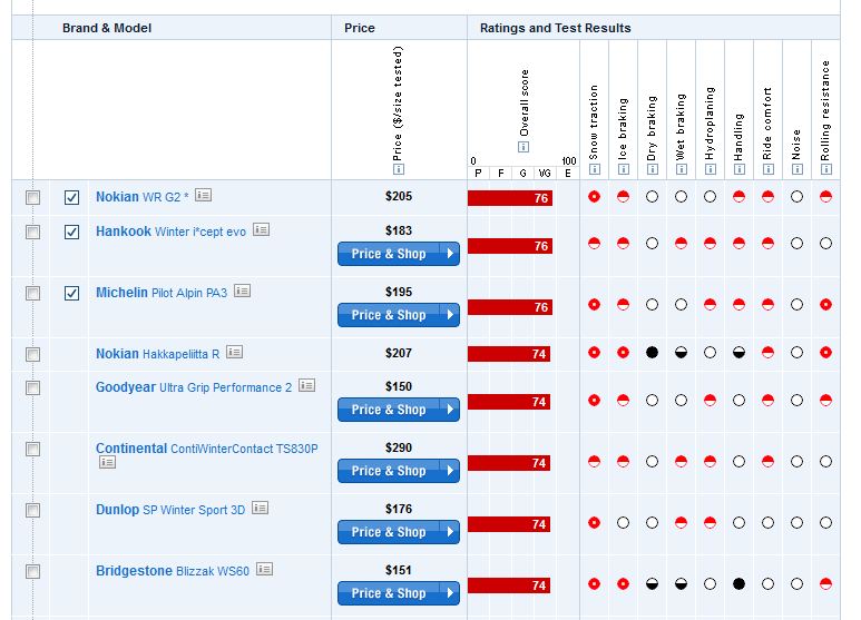

    But wait, there is more:
    Isn't that the 3rd tire here in CU's 'Performance Winter Tire' class, with a much better score and wet and dry braking then your Michelin Xi3 and Xi2s?:

    EDIT: the problem with the above charts is the lack of numeric data. Does the black circle mean 5 feet longer stopping distance or 50 feet? I'll stick to reports that present the data and allow me to interpret the results.

    CU put Winter Tires and Performance Winter Tires to the very same tests, but with different tire sizes typical of the likely users.
    "Snow traction:
    Snow traction reflects the distance our test car needed to accelerate from 5 to 20 mph on moderately packed snow.
    Ice braking:
    We tested ice braking on a skating rink from 10 to 0 mph.
    Dry braking:
    Dry braking is from 60 to 0 mph."
    The Michelin X-ice tires look like an excellent choice for colder inland folks continually driving on snow and ice.
    But for lowland coastal folks like me, winter driving is 95+% on very wet roads with just a bit of snow and ice time at Stevens Pass or Mount Hood Meadows. For this use, the X-ice's bottom-ranked wet and dry braking and below average hydroplaning resistance is a deal breaker. There are better choices available.
