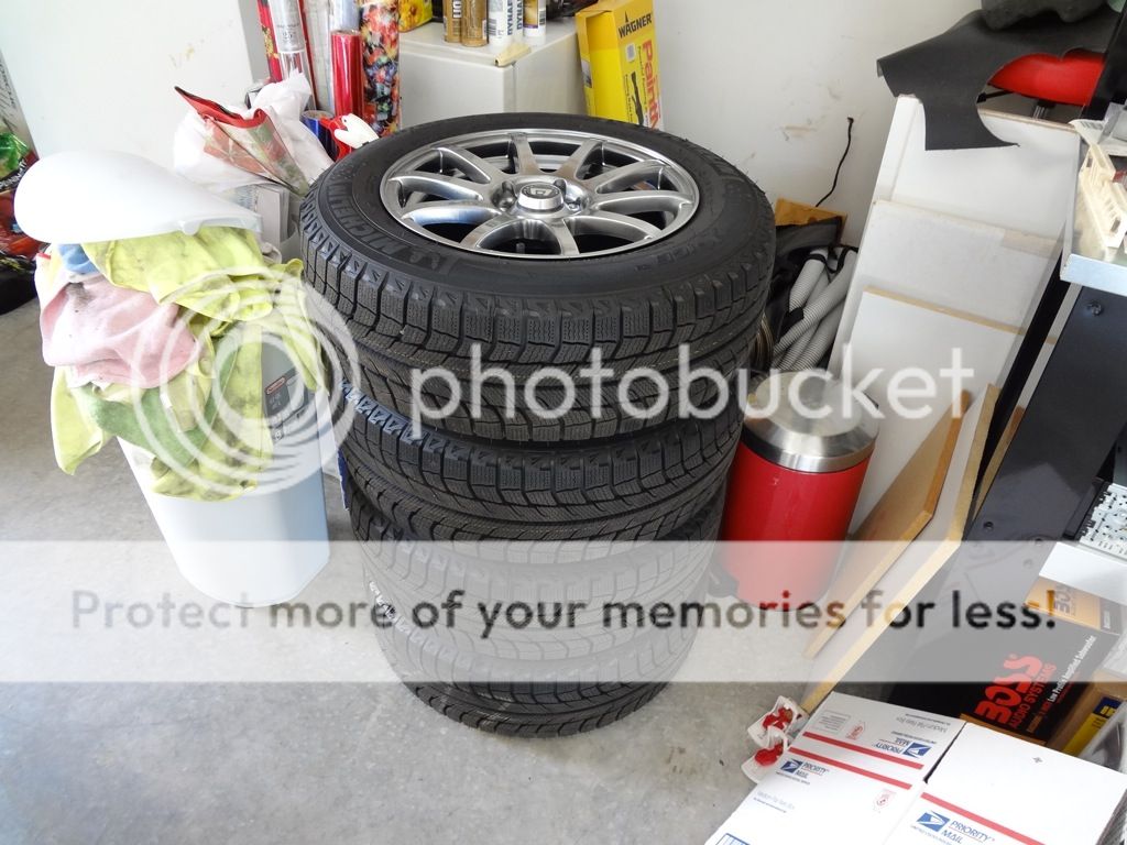

  20. SuperchargedMR2
    SuperchargedMR2 Diehard Rams Fan
    Feb 13, 2011
    673
    179
    Vancouver, WA
    Who are you talking to? I hate studs as the traction on a dry or wet road is much worse then a new studless winter tire and they are very noisy on pavement. The only benefit a studded tire offers is on ice but even there the new studless winter tires perform great. You also never sipe a new studless winter tire as they are sipped from the factory. If you look at one they have thousands of computer designed sipes already. Winter tires have improved a lot in 30 years, you need to check them out. You can see them in this pic.
    moedjo likes this.
