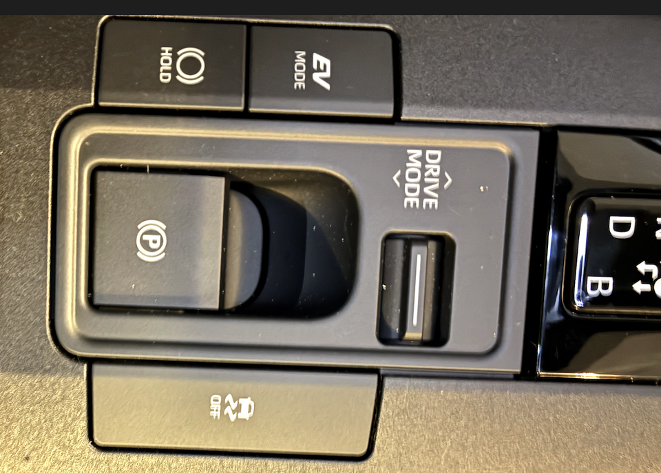

    On a side note, I still don't know what 'Hold' does, lol.

    Setting Hold means the brakes stay locked after you come to a complete stop. They stay locked until the accelerator is pressed. Some people(especially elderly) seem to like it because they don't have to keep their foot pressing the brake pedal at stop lights or drive thrus. Handy for people with muscle weakness in their legs/ankles/feet. Also probably good for people that have to deal with a lot of traffic jams.
    I've tried to get used to it, but 40 years of driving experience without having it made it more trouble than it was worth(to me). I kept trying to put the car in gear because my subconscious kept thinking the car was in Park.

    It was automatic on my MINIs.

    Oh, once you turn it on, it stays on. You don't have to set it every single time. It even stays on between starts. So it probably functions exactly the same as your Mini.

    It helped with a stick shift, which I think my first one was.
    edit: Also the dual clutch gearbox on the more recent ones.

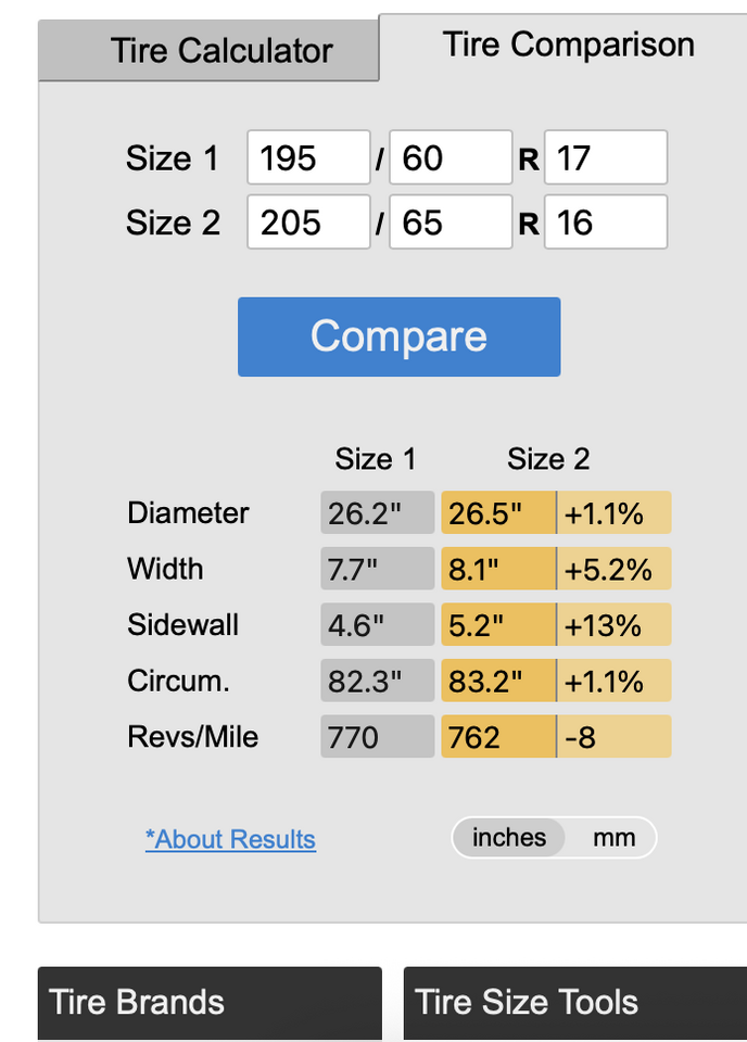

    Get a 195/60 R17 - that's the OEM 17" size...

    I went with Michelin x-ice 205/55R16 tires on new aluminum wheels. You can get the alloy wheels from any tire store, including costco.
    The only issue with the 16" wheels is the car sits lower to the ground making driving through deep snow a potential problem. Handling is good and so is fuel economy.
    Price difference for 16" alloys wasn't significantly more than the cheap steel wheels. You will pay through the nose for 17"+ sized wheels and rubber.
    I don't want the steel wheels anymore because they accumulate too much sand/salt on the inside of the rims on the back wheels. The alloy wheels tend to stay cleaner. I don't have the need for 19" wheels on a compact car to give it that Hotwheels or Tonka Toy look.

    You sure you didn't mean 65 series?
