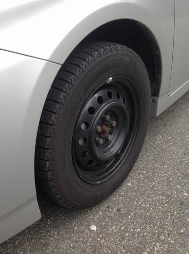

    ^ Yeah, that might look a bit better. I've toyed with getting Corolla wheel covers, but so far:
    (Notice the extremely bare road. I sometimes wonder..., guess it's pretty much time to take them off, after another near snowless winter.)
