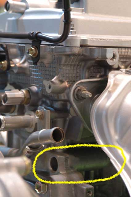

  9. ken1784
    ken1784 SuperMID designer
    Dec 18, 2003
    2,943
    1,383
    67
    Yokohama, JAPAN
    OK.
    Here is another picture.
    Enjoy,
    Ken@Japan
  10. efusco
    efusco Moderator Emeritus
    Nov 26, 2003
    19,891
    1,195
    Nixa, MO
    And that little flat edge facing you on the outside of the hole is where the clip part of the core snaps on.
  11. hdrygas
    hdrygas New Member
    May 22, 2004
    3,650
    Olympia Wa
    Ken you da man best picture yet!! I am doing at least 5mpg better this winter than last thus far. It is colder this winter than last, but not Wisconsin cold by any means.
  12. empannin
    empannin New Member
    Jul 18, 2005
    I installed the block heater and have additional tips for a fast install.
    1. Jack the car up high using the center lift and put jackstands on either side as per prius manual.
    2. Get an old pillow or two to support your head.
    3. Get a good flashlight or shoplight
    4. Refer to the photos previously distributed. You will be putting your right hand up between the passenger side drive shaft the gas engine block.
    5. If you position yourself so that your head is aft of the lift point and midline near the exahust you can reach up with your right hand and see the place you need to insertion it at the same time. Having a pillow or two behind your head helps
    6. You can also verify that it is fully locked in from this position
    7. Drop the power line down after. Suggest aft of the radiatior overflow (pink liquid)
    8. In the same position you were in to install you can fiddle around with getting the connector in. In the correct position, the wires should start heading aft before bending and heading forward (and up)
    9. You can run the power line between the hybrid inverter and the coolant tank (pink)
    10. I routed the line down to near the driver side fog light.
    11. It helps to remove the plastic cover on top of the radiator (it also has warnings about the HV power supply for the headlights)
    Other comments: Make sure you have jackstands. Not only is it not very safe to use only the jack, but it would be in the way of positioning yourself where you can best see the plug hole. You should have a buddy, and make sure you test the stands before going underneath (+ wheels chocked). Given the lack of ground clearance, a jack accident would result in serious injury.
    If you are having trouble finding the place where it is inserted, review the messages already on the board + the excellent pics. Think of each picture as a map and focus on finding your way by hopping from landmark to landmark.
    Best done in a garage or someplace warm. If you can only do this outside plan on doing it soon as it is getting cold... Took me 30 to 60 mins to put it in the first time. I think I could do a 2nd in 10 mins. Hopefully this will help you as well.
    Thanks for all the comments and pics previously posted, it would have taken forever without some guidance!
    Eric

  14. Lather
    Lather New Member
    Sep 25, 2005
    27
    Got my heater and got it in. To everyone who posted pictures and advice, thank you. It would have been a nightmare without you. Instead, it was a breeze.
    I decided to find the hole first. Once I found it from inside the engine compartment it was simple to find it from underneath. I case anyone is curious; this is how I did it.
    From the engine compartment, slide your arm into the space between the brake reservoir (yellow fluid) and the relay box. Reach back behind the engine and go over to the inverter reservoir (pink fluid). Then, as you move down, you’ll feel 3 or 4 wires taped together, below that is an exhaust tube (the Prius doesn’t use a log manifold, it’s more like a header. Just below that, on the side of the block facing the driver is a small hole going into the block towards the passenger. On the backside of the engine (facing the firewall), you’ll feel where the block heater clip snaps on.
    Once you’ve got the location down, you’ve got it made. I drove up on the ramps, chocked the wheels and stuck a couple of tires under the car, behind the ramps. I crawled under, in front of the passenger side and looked up at the exhaust. You can easily see the exhaust pipes. If you reach below the exhaust, you’ll find it. From there it was simple. Grease it, insert it and push it until it clicks. The power cord goes on with the cable facing towards the firewall. It took about 15 minutes to find the hole and another 15 minutes to drive it up the ramps and install it.
    BTW, when I got the car I used a hydraulic jack to raise it up. I never felt good about that because my jacks are for my truck and way too big for this little car. I went out and got Rino 8000 ramps and a set of chocks from Autozone for $42. It made a world of difference.
