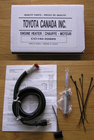

    <div class='quotetop'>QUOTE(ken1784 @ Jan 21 2006, 08:39 AM) [snapback]194595[/snapback]</div>
    I received mine today, from the same source, Toyota Canada under $45.00. This will be the weekend to get a little dirty. ;)
    My local Toyota parts dept. couldn't find it in their parts database here in Long Island, NY, but they tryed to sell me and extended warranty for $1950.00. :angry:
