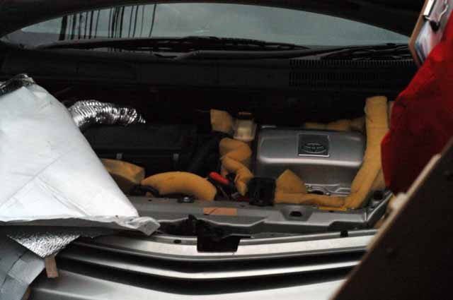

    So, we, Japanese, did block the front grill as I wrote post#130 on this thread.
    Please find the attaced picture how we did.
    Ken@Japan

    Yow!! warm_room.jpg is *hilarious*! Warm, cozy, snuggly HSD.
    I see you've got a warm-air redirect hose in there too... looks
    very similar to mine.
    _H*

    Well it is clear that this would be easier than what I did. There appears to be a lot of holes under the engine will that allow air to come up into the compartment?

    Ken, if that fiberglass insulation you stuffed into the engine compartment??? If not, could you please advise. Also is that a windshield sunshade and do you use it as a thermal blanket and drape it across the engine? Please advise.

    It is a sponge material in the engine compartment.
    You're rigjht. The blanket is used to cover whole engine room.
    Ken@Japan

    I would be very worried about stuffing so much insulation around a motor, unless it was operated in Arctic conditions. Wouldn't Mineral Wool be a lot safer than fiberglass?
    Would it even be desirable to have insulation around the inverter? I thought the inverter was supposed to run a tad on the cool side anyway.

    I think so too.
    But, the temperature is controlled up to 50C, so the sponge material is not bad.
    Again, it is controlled up to 50C as same as in summer time we observed.
    There is a gear train in that area, and we know it is better to keep the gear train warm to reduce the power loss.
