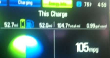

    The cross overpoint for fuel usage between a Volt and a PiP, using EPA data, is over 100miles, not 50.
    What most people don't get is how many "local" miles they rack up compared to the occasional long trip, and how much the initial battery charge changes the overall MPG. The 9MPG difference on the highway takes quite a while to make up the 17 miles of extra battery range over the PiP (or 38 compared to the Prius)
    Of course many prius drivers can do better than EPA (though the average at fuelly is below EPA). So can Volt drivers.
    EPA for the 2013 volt is 38miles per charge. My 2011 was 35miles per charge. May-October I get 46-55 per charge.
    Getting 40miles a day of EV, is pretty easy for a decent driver in a volt.
    EPA rated 40mpg on highway. When on Gas and when I drive right-lane at steady 65, I do better than EPA -- generally 45-50mpg with the occasional 60MPG ICE driving when the weather is prefect. My best 250mile trip was about 95MPG (charged at home and the destination, so about 57MPG on ICE). My only really long road trip was when I bought the car in TX, and drove it 900miles home. Obviously not broken in but we still averaged 42mpg on the ICE (44 overall as we charged it in TX and when we stayed overnight in OK).
    Here is screen shot from a recent 100mile trip (one charge)

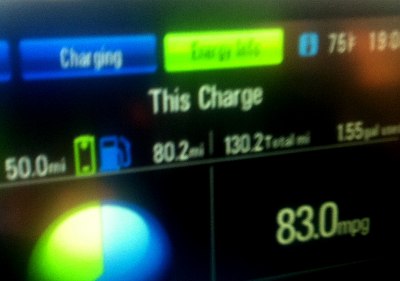

    And here is relatively average ~130 mile airport run from last year (again just one charge at home) with the car packed to the gills
    Coming back to the "overall" MPG, if one drives 12,000 miles a year, of which 10,000 are in EV and 2,000 are on long trips/ICEMiles, then the Volt would use approximately 50 gallons of gas for an overall 240MPG (+electricity of course). Electricity is, for many of us, much cheaper. (My fuel costs per mile over the past year are about .026/mile, which is cost equivalent to 138MPG$.)
    Now that I can charge at the airport, and various public places, I'm taking less medium trips that use much gas. I expect my lifetime MPG to level out between 350 and 400MPG .
    I'm not knocking the PiP, it is a solid car and for people with very short trips/commutes or with kids needing a 5th seat it can be ideal. But few driving patterns make it more fuel efficient than a Volt, so when people make an issue about the ICE fuel efficiency its generally a red herring.
