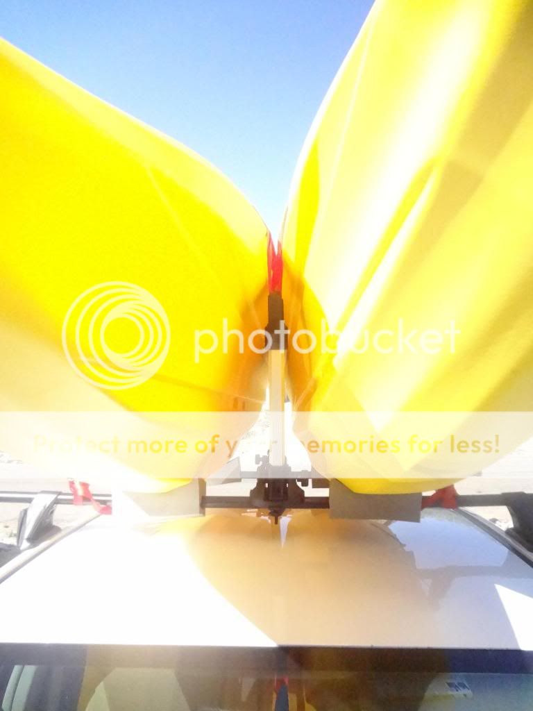

    First, I just wanted to say thanks to all you for the help. I had the same problem and now that I have a pretty good set up I thought i'd share it and put it all on one thread.
    Car: 2012 Toyota Prius- Bare roof- no moon roof.
    Kayaks being used in pics: (2) 10.4 ft. Equinox -- reviews here, purchased from Costco

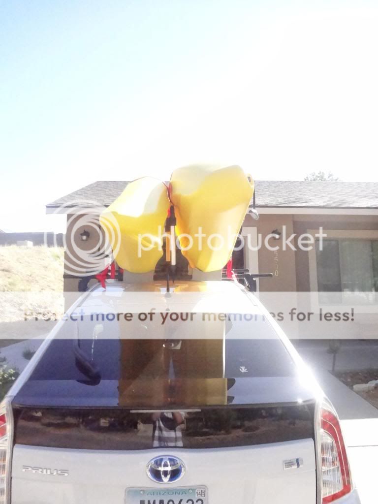

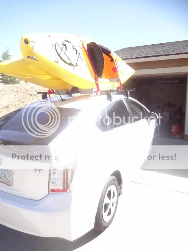

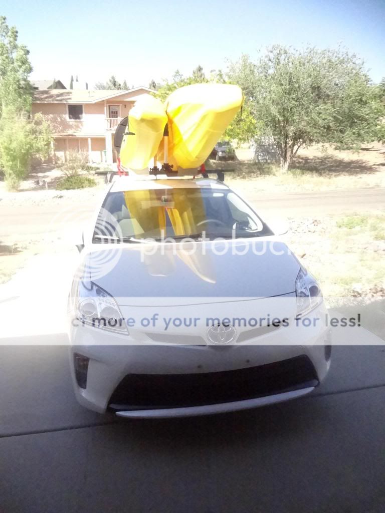

    After about a month of driving around to different stores and reading multiple reviews and hearing from others on this board I went with this set up- I will post pics first, then give the break-down
    [​IMG][​IMG][​IMG]

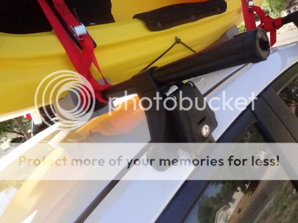

    Racks: Yakima removable cross bars- Purchased from REI in Phoenix, AZ -
    Breakdown:
    Q-Clips: Q5 (rear)
    Q99 (front)
    SKS Locks 4 Pack
    Q Towers: attaches crossbars to vehicle
    58" Cross Bars
    Subtotal for Yakima Removable rack system:$311.15
    Center tower: Malone Stax Pro 2 (allows you to put two kayaks on roof easily, comes with straps, 2 center arms bars that fold down, and 4 foam blocks to rest the kayaks on) - Purchased at Bass Pro Shop in Mesa,AZ- on sale for $99.97
    Total cost before sales tax was $411.12, your cost may be + or - depending on sale prices, coupons,rebates ect. Also if you feel you do not need locks (SKS locks) you can save 40-60 dollars.
    As suggested you should use front and rear tie straps on each of the kayaks and hook them into your tow points to stabilize it even further.

    Let me know if you have any questions, I will try to answer them. Or if you have any suggestions to make the post better.
    Please keep in mind this is the first time I have ever installed a rack system or put kayaks on the car. Total time it took me to from opening the boxes to getting everything installed and the kayaks on the roof was about 2 hours, i'm sure it can be done faster as it's really not that hard.

    I saw a Honda Fit with a kayak on the roof while on the freeway the other day. The kayak was rocking back and forth, front to back, because of the short distance between the crossbars and the relatively long unsupported ends.
    I would definitely consider tying both of the kayaks to the front end and rear tow hooks with some straps or ropes and straps to prevent the front to back rocking action I saw. Just a bit of tension on both ends will keep it really solid.

    I would, but since they are a little over 10 ft. I haven't really felt it necessary . If it were anything more than 12 ft of course use tie straps on the front and rear of each end of the Kayak onto your tow hooks. For sure though on any prolonged trip yes no matter the length use the downs on each of the Kayaks ends'.
    For shorter trips I think this set up is extremely stable as I tried to rock it and it seems very very solid, as long as the straps are tight. I will let you know more tomorrow as I will be going to the lake (i will hop onto the highway instead of going through town so I can get up to 70 miles an hour and see how they fare). Later on I might replace the foam blocks with inno cradle stops

    Still, that's a lot of drag up high, and again, there is only a very short distance of support in the very middle. Even if it seems tight, at rest, it's a different story once everything is in motion, and the car's suspension will also contribute to the rocking tendency in addition to harmonic vibration and wind drag.
    At least with the ends secured, everything will move as one unit and not just the kayaks and roof rack putting stress on your thin roof sheet metal.

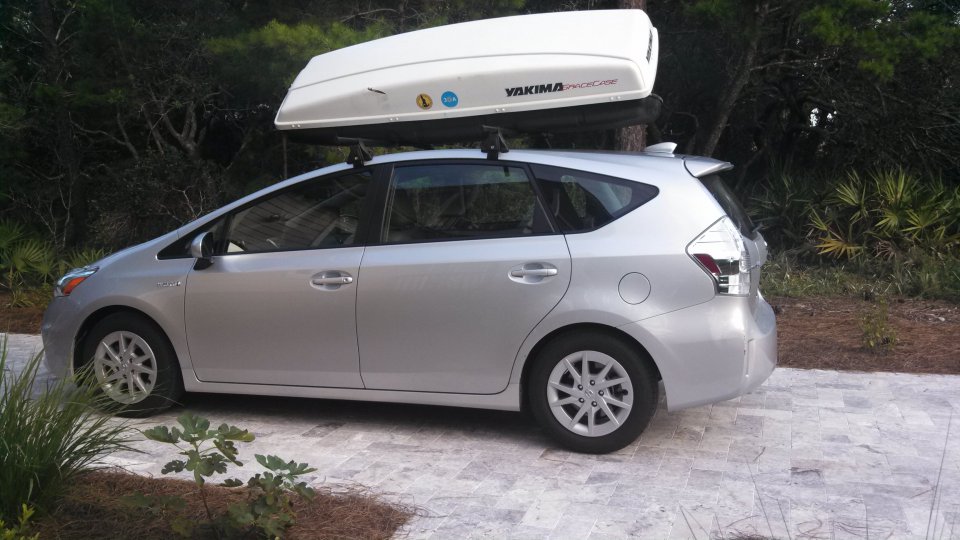

    [​IMG] 2013-07-28 18.42.25.jpg I've got the Yakima gear that I have used a few times recently with my 2013 Prius V. Have driven from Ohio to Florida with a giant Yakima Cargo Case on top. It rode like a champ. I of course had a drop in my mpg but the experience from inside the car was really the same as with nothing on top. I didn't feel any drag and it really didn't make any wind noise. The bars without the cargo carrier actually did make a good bit of wind noise.
