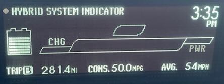

    This is with my normal highway driving, with minimal drafting,at 65mph.
