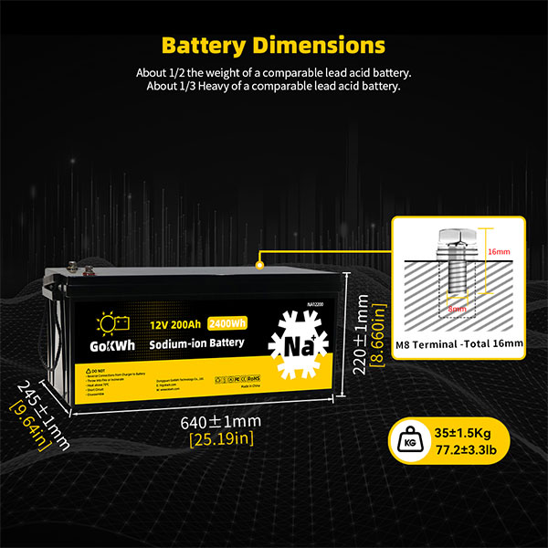

    I question the size, 4 x 200Ah Sodium ion cells will fit in the same spot the original lead acid 12v battery fitted. Just requires a good active cell balancer as the Prius max 12v recharge is well below the 16v the 4 x 200Ah cells can handle, and not much hope of drawing more current than the 200Ah cells can deliver, or charging faster than they can accept it ..... It would certainly be enough capacity to run an inverter from for camping or emergency house power during a grid outage ......
    T1 Terry
  4. MAX2
    MAX2 Senior Member
    Aug 12, 2024
    1,436
    490
    101
    Third planet from the Sun
    It is unlikely that 4x200Ah will fit into the auxiliary battery compartment of the Prius.
    The dimensions of the 200Ah are quite large. Weight 35 -+1.5 kg.

    Ummmm...... I guess it depends on the brand cells/battery you buy. There is no value in buying a battery in a battery case that is built out of prismatic cells, and the last thing you would want to buy is a battery built out of pouch cells unless it is a factory build and has cooling plates between the pouches. They are by far the most prone to heat destruction by bursting the pouch on the centre pouches if they are all squeezed in together in a single case, the inner pouches have no way of dissipating their heat. The only other type of battery built in a case are made out of cylindrical cells, fine for high output use, but no good for cyclic use ..... too many variables between the cell parameters with such low capacity per cell, all connected in parallel to make capacity.
    The last lot of sodium ion cells I was testing, before my house burnt down (not related) were shorter than the Winston 100Ah cells and the same physical sizes otherwise. I have been using ex house battery pack 100Ah cells in a compressed pack of 4 as a 12v battery in all my vehicles once the lead acid one passes on, they seem to be fine for such a low load job, even less load in either on my two Prius, they fit in the battery spot just fine.
