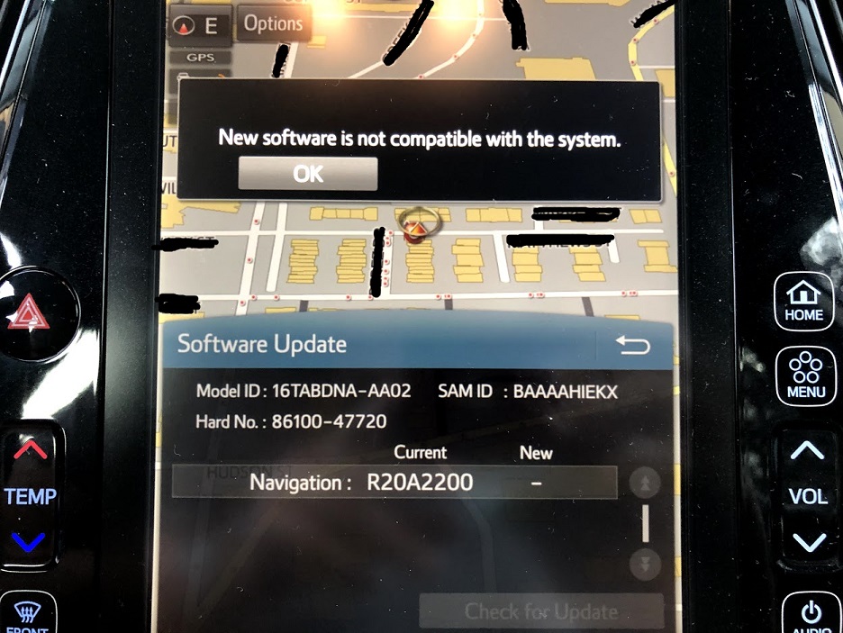

    How do you check what version your car has now? And what is the latest version number?

    To check your software version on Prime with the large 11.6" screen press Menu->Settings->General->Software update->Update. Current version is displayed under the Current heading. Latest version is R10A8100 for 2017-2019 and R20A2300 for 2020.

    I was at the dealer today for my first Toyota Care service, and I asked about this update. I even showed them the file from the link with instructions. They told me that this update is not for my 2020 Prime, only for earlier models and for Prius. I know that's not true but that was as far as I could get. Hopefully the link will get updated so I don't have to pay for access to the download or go back to the dealer.

    I have a 2020 Prius Prime XLE with the 11.6" infotainment screen.
    I have had intermittent reboots of the infotainment system since we bought the car in August, 2019.
    Using the information from this thread I got the dealer to apply R20A2300 last week. They asked me lots of questions about whether the reboots occurred with Apple or Android devices, what the software release they ran and whether the phones were USB connected or not. I pointed out that there was no apparent correlation between Apple/Android physically connected or not.
    However, I had the same reboot behavior today after having the fix applied.

    Glad to hear your dealer was able to locate the latest update for the 2020! That may help other 2020 Prime owners to convince their dealers that the update exists.
    I also experienced a reboot yesterday on my 2018 Prime Advanced running version R10A8100. I had an Google Pixel 2 android phone connected via bluetooth at the time. No USB devices were connected.

    I mentioned the frequent screen reboots today to the service guy at the dealer when I was getting the oil changed, and he said that there is an update available. This turned out to be the same update as earlier models had available, so it seems that the 2020 Limited can finally be updated. I don't know if the link posted above will work, but at least a dealer will do it.
    I don't actually expect that this will fix the reboots, however.
