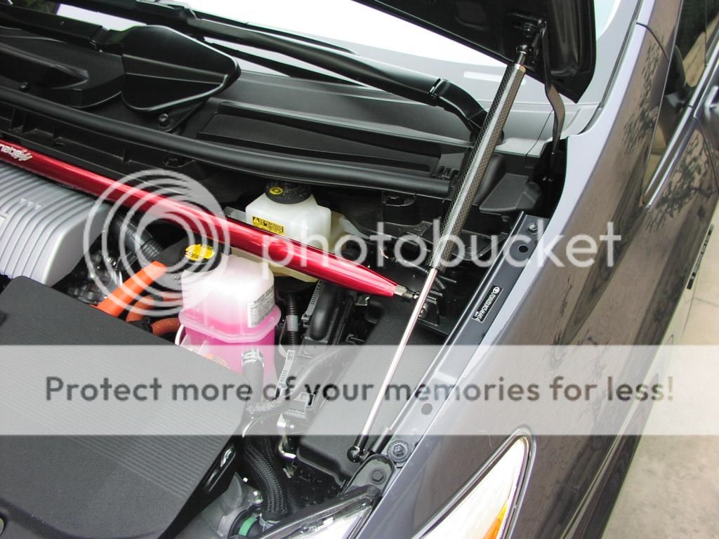

    I just noticed your car has the same plastics as mine. In the video (I'm still uploading), I mentioned that maybe older models didn't have these, but I see now in your pic that yours has it, too. Is the top bracket mounted on the top bolt or the bottom bolt?

    Using Burna J's image, I've marked in red the parts I had to Dremel out.

    The more I look at Burna J's pic, the more I'm beginning to think I installed it all wrong. Is there anywhere I can buy the plastic parts I trimmed off? Ugh. I hate that I Dremeled it. I know it's my own damn fault. I wish I had internet access where I was when I installed these, but I didn't.

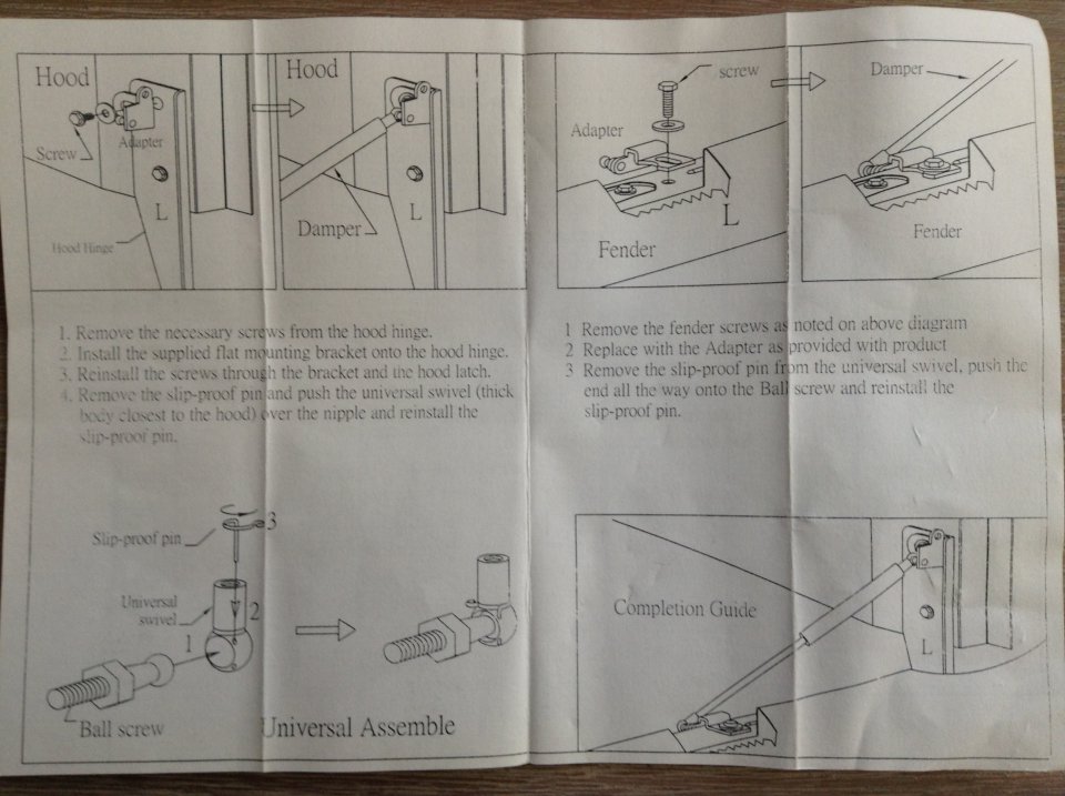

    When I installed mine, I used this. No internet access required. (y)

    That's how I first installed it, following those instructions. The hood wouldn't close. Also, in the diagram, it shows L but it's installed on the right hand side. Doesn't L stand for left? If you look at the lower bracket, the ball is towards the bottom. I tried that and it wouldn't fit. I even tried flipping it over and putting it on the other side. My brackets are clearly labeled L and R, so I went with that. The instructions at that point was useless. I had to use trial and error. I would have loved to have internet access to double check here in these forums but I had no access. Also, the way yours is installed wouldn't work in my car. I just tried right now. Everything in the kit looks the same as yours except for the color of the dampers. But you used the upper part of the hood's bolt to mount the bracket and the bottom bracket's ball is at the bottom. Weird.
    I just checked every possible combinations to install these just now and the way I did it is the only way. I'm 100% certain now I didn't make a mistake and the Dremeling I did was absolutely necessary.
