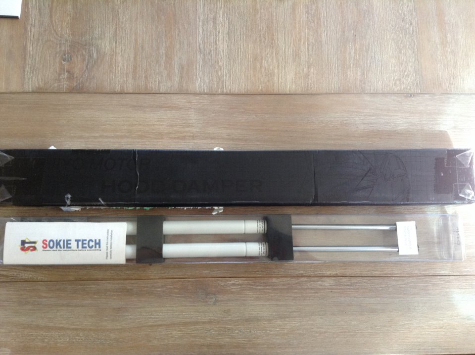

    I ordered the white colored hood struts off ebay. Received them in a week.
    2009 2010 2011 2012 Toyota Prius XW30 White Color Shock Lift Hood Damper D4N5 | eBay

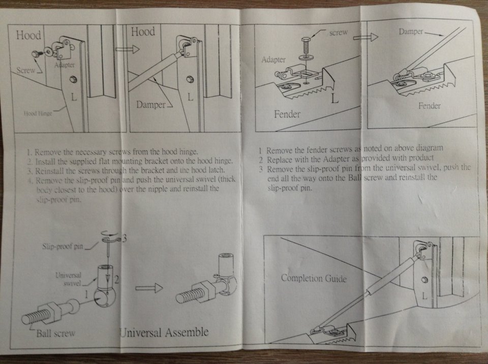

    They came well packaged and the instructions were very easy to follow.

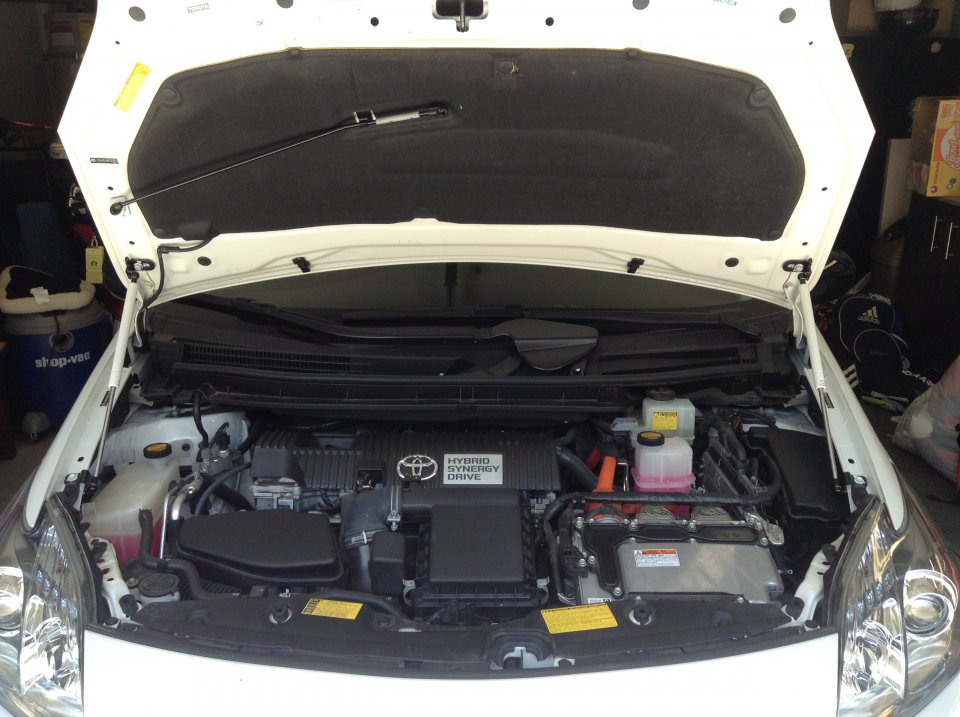

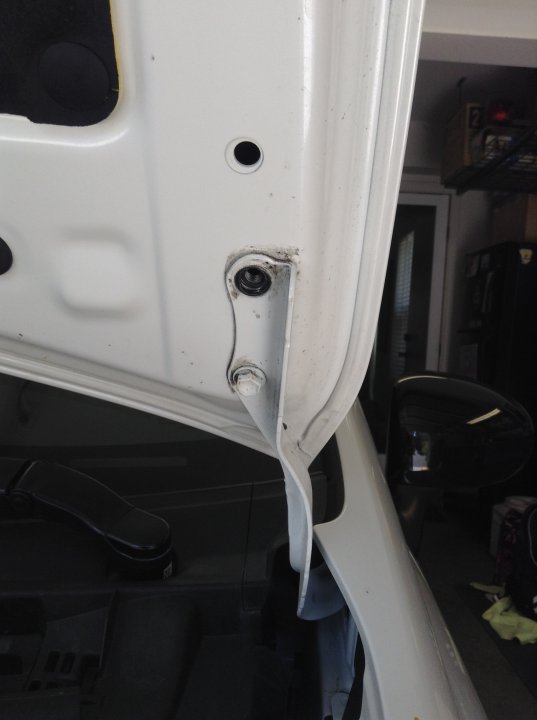

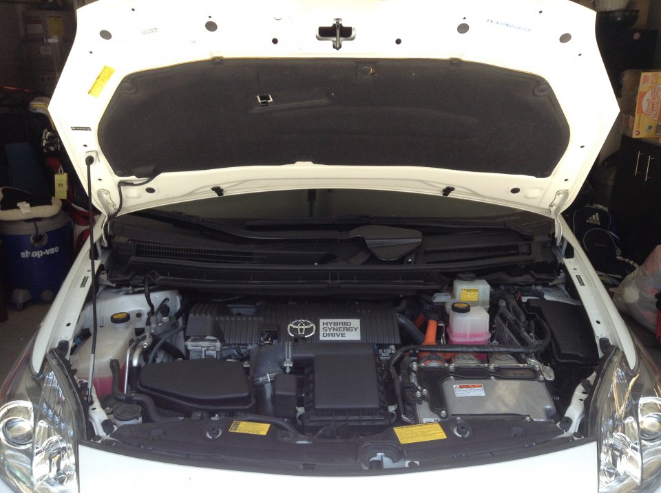

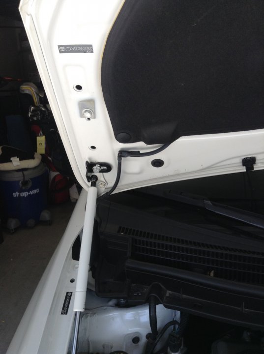

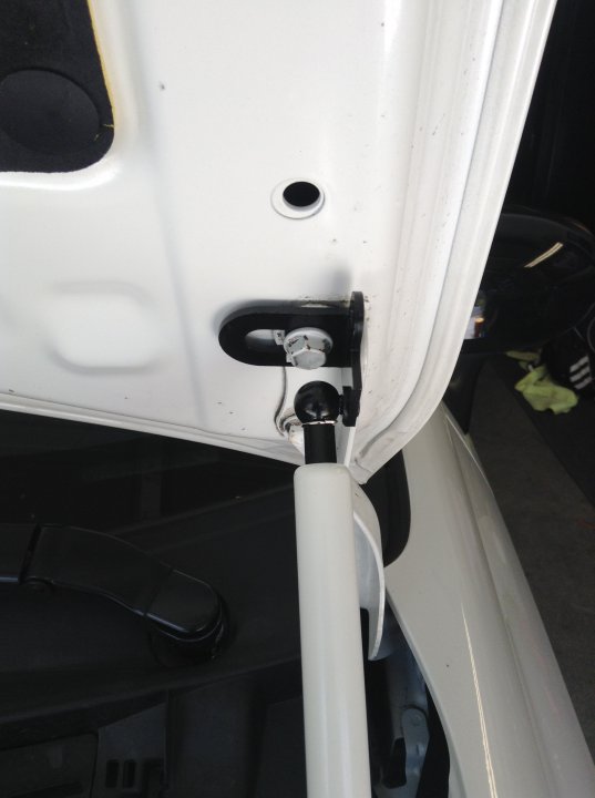

    Install the new bracket and reinstall hood bolt. You have to remove the small silver pin from the strut socket. This pin, when reinstalled, will keep the strut from coming off the bracket. IMG_0082.jpg

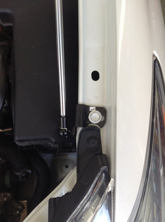

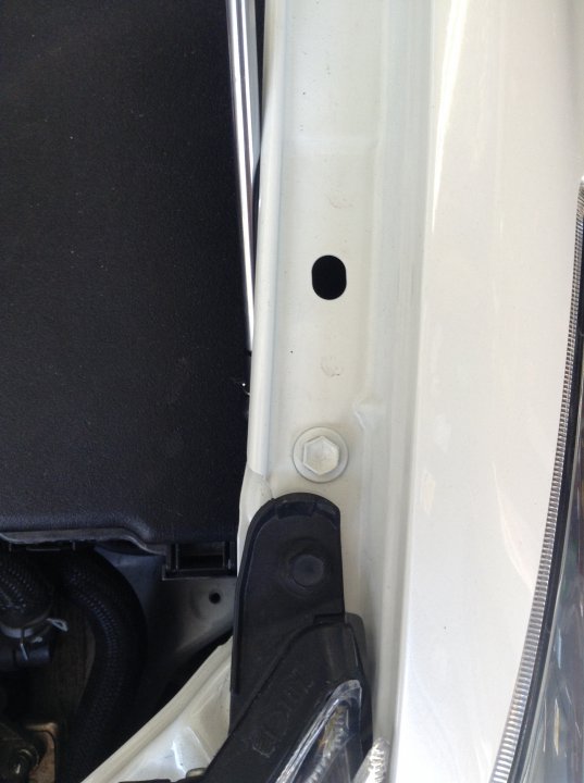

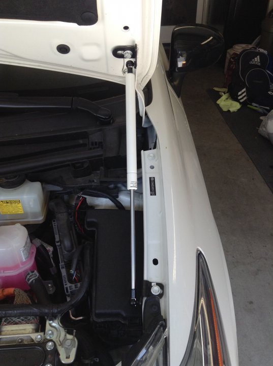

    Repeat the small pin removal, attach the socket to the new bracket and reinstall the pin. Here is one side complete. IMG_0085.jpg
    Repeat the same process on the other side. The first side took a little longer due to making sure I followed the directions. The other side took 5 mins. to complete. In all, it took around 15 mins. to install. IMG_0086.JPG
    One thing they don't say in the instructions is to remove the old stick support. I did because the bracket rubbed the strut body just enough to nick the paint. I repaired it with touch up paint. Maybe you can bend the bracket to clear the strut body and leave it in to retain the stock look. IMG_0087.jpg
    The struts work great and the white is a close match to the BP color. I would highly recommend these if you hate the hood support stick.

    Did you have to cut the plastic next to the fuse box? I think if you close it. The top will rub against the damper on the right? I think L or R the same. I notice that on your picture you have the L install on the R side. Not sure if it matter
  8. DoubleDAZ
    DoubleDAZ Senior Member
    Jul 2, 2014
    1,209
    322
    Peoria AZ (Phoenix)
    I could be wrong, but looking at the instructions photo, it looks correct to me. Besides, when you make a left turn, you are inside the vehicle, not standing in front of it. AFAIK, directions on a car are always relative to the driver position.
  9. Seanzky
    Seanzky Member
    Apr 5, 2014
    150
    Whatever you do, just follow this thread. Don't follow the instructions. It confused the hell out of me.

    Did you use the washer that came with it? My hood damper came with 8 washers. I see that you use the original factory bolt near the headlight. I had to buy new one since it wasn't long enough.

    Looking great! One question though. Can you open the fuse box cover after the install? It just looks very close to it.
  17. Starbrand
    Starbrand Senior Member
    Dec 17, 2014
    493
    1,502
    Westmont, IL
    yes, the fuze box is still accessible :)
