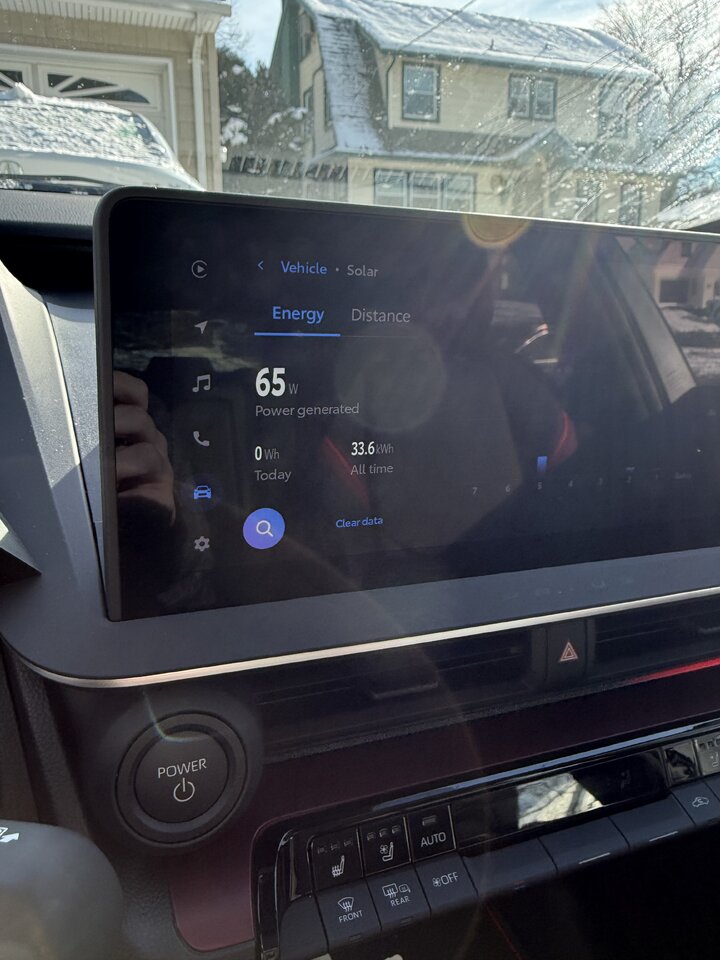

    Okay quick update. Looks like the solar roof isnt even charging the battery when in deep rest. See photo of voltage being only 12.2-12.3V overnight. Car has been in direct sunlight from 8am - 11:30am[​IMG]
    IMG_3954.PNG [​IMG]
    Again no obstructions to the solar roof outside. [​IMG]
    Then when i turn on the car and go to the solar tab, states 0 Wh generated today but now registering 65watts and the watts generated rose to 1Wh in the short time the car was on.
    Suspect ill have to take it to a dealer or something.
    Sorry about the broken images, im not sure how to remove them from the post.

    There must be a few others with solar roofs on this forum. I wonder if theirs are still working in the winter with low sun angle (small cos(theta)).

    Here is the solar-position calculator. The cosine of the solar zenith angle is the factor that multiplies the solar radiation. You can calculate that factor at different locations, days, and times. See how it varies by the hour and day at your location.
    In reality, it will be a lot worse than the cosine of the zenith angle. In fact, it will be worse than the square of that angle, as a higher angle also results in the solar panel being hit at a higher angle. which is an additional cosine factor, and the sun’s rays are passing through more clouds and humidity. This is in addition to the cosine factor that results from the rays entering the Earth at an angle. So, expect only about 10% or less sun radiation being received by the solar roof in the winter. That explains why it stops working in late fall.

    Yes, I explained further that in the winter, you would be receiving no more than about 10% of what you are receiving in the summer, even on a perfectly clear day. That’s probably not enough to turn on the solar-roof computer.
    Therefore, it is unlikely that there is a malfunction. The solar roof only seems to work during the summer, late spring, and early fall.
