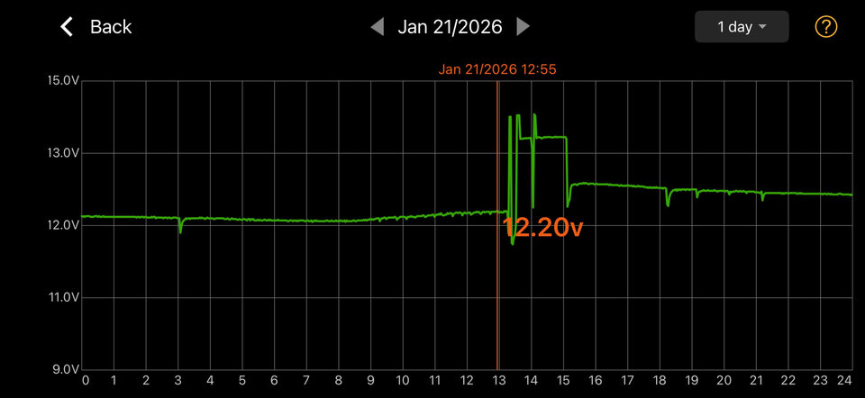

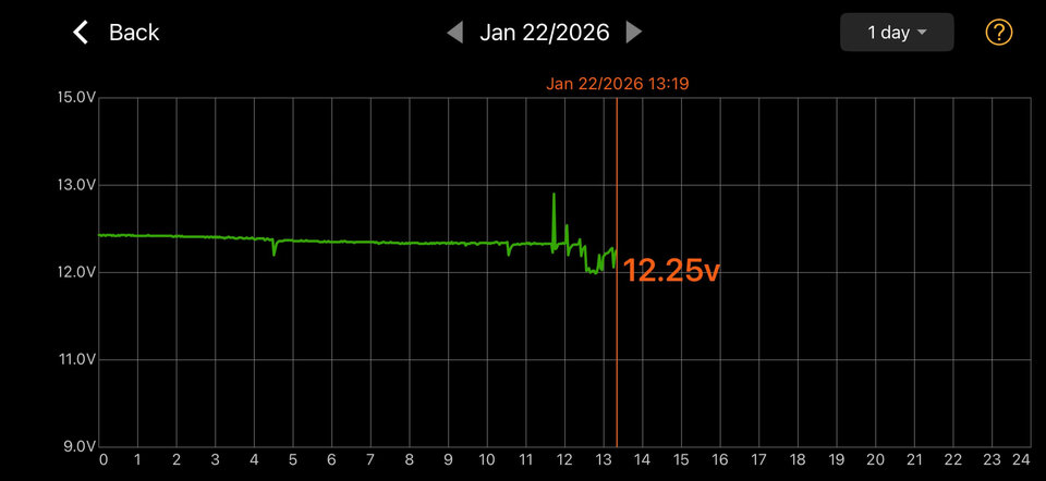

    I actually have a 12v monitor already. I dont notice a significant jump in voltage with the battery when in the sun (when my car is off). See the two images of today and yesterday, it was in the sun from 9am until 3pm which have relatively the same voltage as in the middle of the night. The big jumps are of course me plugging it in to charge.
    When i get into my car in the middle of the day and go to the solar tab in the infotainment, it will tell me 0Wz 'generated today' obviously meaning nothing was charged however it will then start generating watts when i keep the car on or plugged in. Could this be a bad 12V maybe?

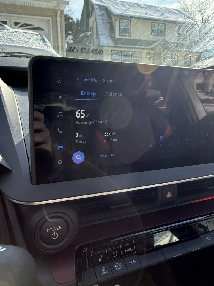

    Figured id chime in with some pics I took today. The day ended up pretty clear and sunny. The 8am Pic is just before powering down getting to work. The the 3pm pic is when just powered up leaving work. The last pic is after a 20 or so min drive home parked in the garage. This leads me to believe that during the day there isn't quite enough strong direct sunlight during the winter to "activate" the solar charge controller unless the car is powered up. And the 3wh was "stored" in that 20 minute drive. Im very curious to watch as the year progresses to see when it starts storing that energy it generates during the day. If it doesn't look like its going to start storing any of that energy as spring comes and goes then ill take it into the dealer and have it checked out. Until then, ill just keep an eye on things.

    thanks for your pics. Definitely similar to what i've been experiencing. Wonder if what you suspect is true. Im curious how the summer will work again.

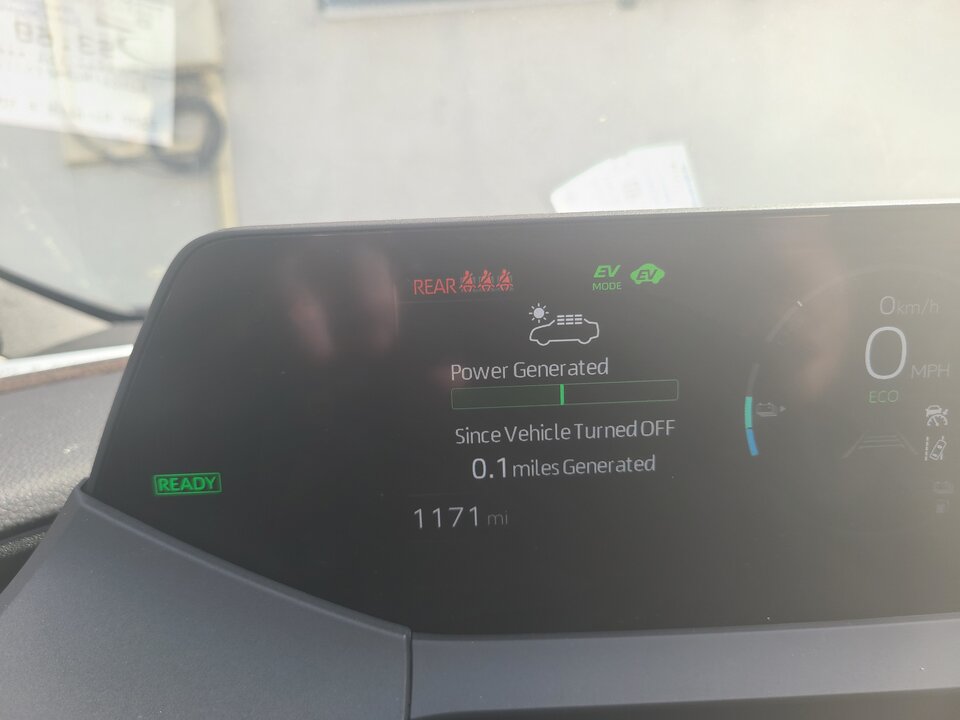

    Hi , I haven't had time to come back to this board for a while. I took a few photos of that meter as requested. I tried to add one to this message, but got an error message. In any case, it usually says a small amount of miles was added since the vehicle turned off. (the last time .1) (Sometimes 0 though)However, still no real drivable miles, although it has been very warm and sunny here lately. I haven't had a chance yet to see any new messages others have written, but will check for those next.
