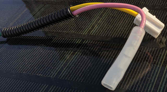

    This is my first post to Prius Chat. I’ve been lurking for way too long, always intended on creating a sign-in, but put it off far too long. So, I will attempt my first upload; a picture of the connector I found on eBay.

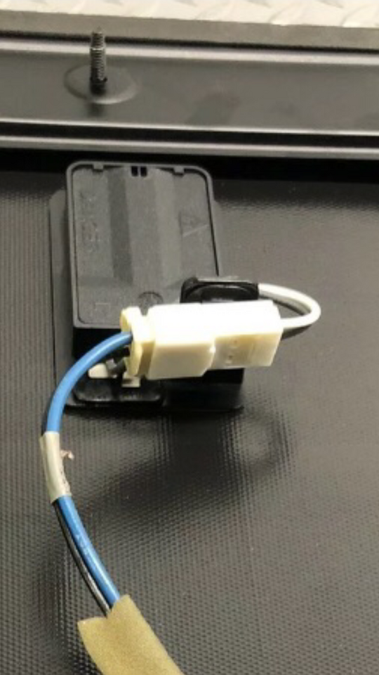

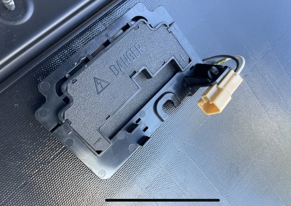

    Now that I’m looking at those photos from 2 different eBay listings, I can tell the connectors appear to be different, and the panel junction boxes are certainly different. I’m guessing they have most likely changed throughout the years, and my car built June of 2010 probably would be different from later model years.
    I’m now thinking I might have to buy a male/female pair of crimp connectors to cut and add to the Blue/Black part of the harness and a second par for my twin-lead runs.
    Most likely impossible to tell from the picture, but it looks like it could be 14 AWG wire, but could be 16 or even 18. I’m wondering if any of those harnesses are in any Toyota documentation. I only wanted to use 12 AWG to minimize the added length resistance, and the circuit breaker that would be inline when using the panel for ventilation.
