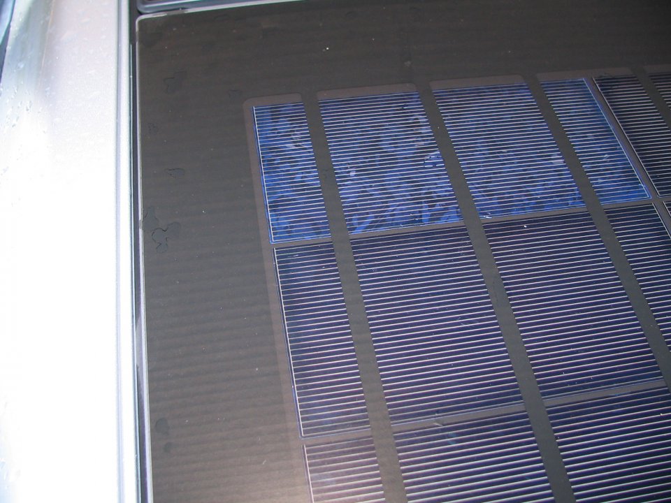

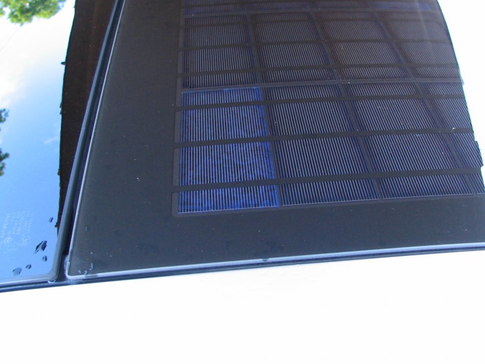

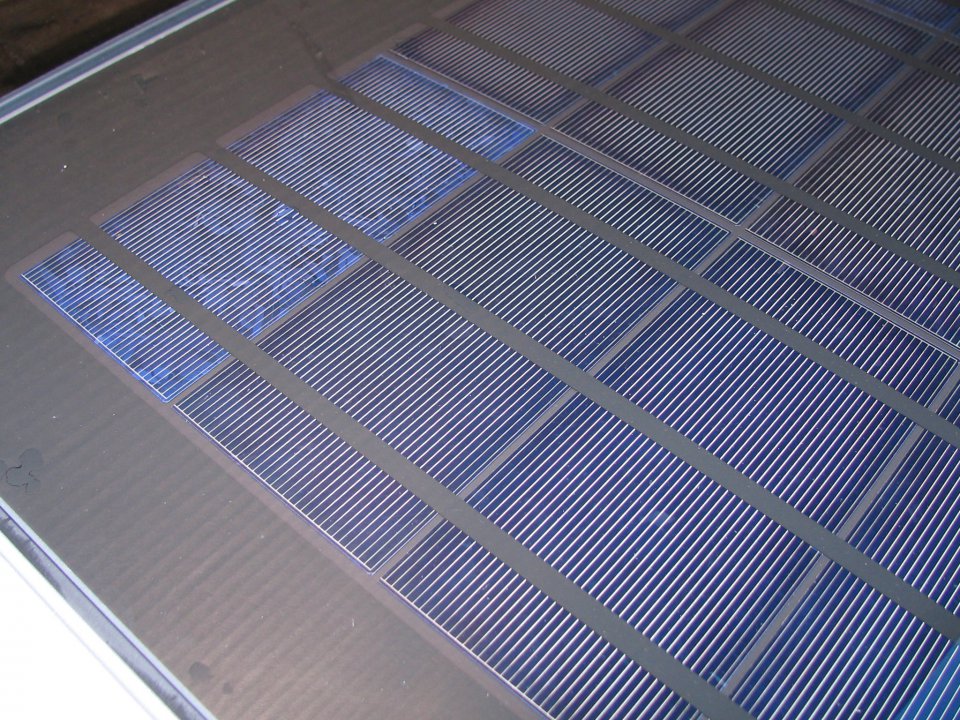

    Here are the pictures.You can see that the other cells are starting to do the same thing. 001.JPG 003.JPG 005.JPG

    Wow, that is weird! Look Ma, goes from BLACK, to BLUE! :eek: I wonder if the dealer would let you keep the defective panel? Or, hook up a volt ohm meter to it when it is out of the car. I would love to know if the discoloration is affecting the voltage output??? Does your fan still work? I just sent an email to a friend in the Solar industry, linking him to this thread. Hopefully he will get back to me on it if this is "normal" or a defect...
    Thank you for posting the photo's, they are worth a 1000 words!

    Fan is still working and taking pictures outside is kinda tough, I shaded the area with a piece of cardboard to take the above. The areas are more of a greenish blue but the camera doesn't show it that way. Still waiting for the dealer to tell me what is involved before we get into it. If I keep pushing they may not do it. I think I will try the customer service number. I know they have offered to replace it but the terms bother me. Please do post any info from solar professionals that you find. Thanks.

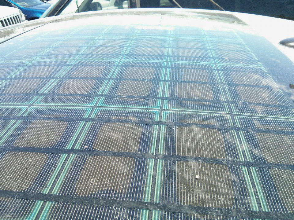

    You're not the only one - my panel looks similar, but the blower continues to function.
    Dirty panel, but a multitude of "colors".
