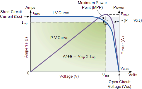

    Not necessarily. If those figures are Isc (short circuit current), and Voc (open circuit voltage), as PV modules are commonly specified, then it cannot be an 80 watt unit. PV max power is always less than the product of those two figures, 60 watts sounds reasonable.
    OTOH, if those are the Imp and Vmp at the maximum power point, then it could be an 80 watt unit. But that current and voltage are usually buried below the topline specs. The safety folks focus on Isc and Voc.
    Here is a representative modern PV I-V curve. Back in the old days, the curve didn't fill the rectangle nearly as well, so I dropped much faster with increasing V.

    I'm sure your analysis is closer to correct. I just simplemindedly multiplied the two numbers Toyota supplied, just to get a quick upper bound on what the power could be.
    Reworded the earlier post slightly.
