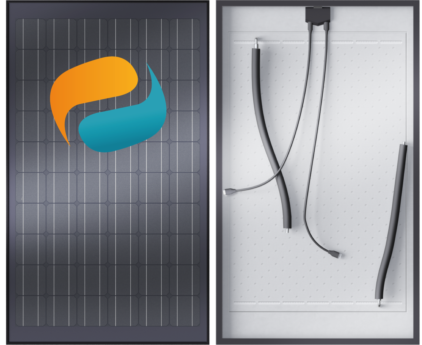

    ok here's that last one;
    if you're out of roof space there are companies that retrofit water jackets to the back of panels. This not only increases panel efficiency by capturing hot water for home use ... it keeps panels cool, which raised their efficiency ... a double whammy! The company below actually sells the panels already installed.
    2-in-1 solar - DualSun
    pretty sweet.
    it's been a while since i searched for the US/retrofit companies, but they're out there. For PHEV owners ... this is what you call, "future proofing" .... BIG time.
