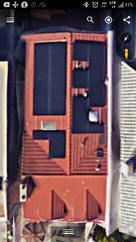

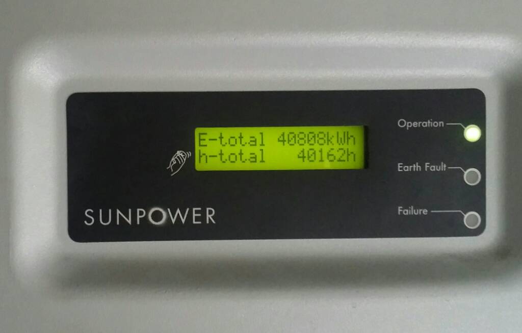

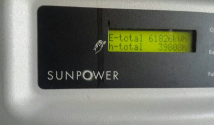

    Ok .... to put the thread back onto a more benign nature - here are pictures of our 2 inverters, which have been running flawlessly for 10 years, this upcoming December.
    Does one collectively (adding the total together) read this figure as almost 202K kWh's?
    Or does one simplify it to a lower gWh number.
    That's one question. The other question is even more convoluted
    We've had a ONE plug in for over 8 years of solar operation, which still allowed us a bit of surplus. Now we have two plugins as of almost two years ago. The increased power consumption of 2 plugins has resulted in <1kWh/day, when averaged across almost 10 yrs of solar generation. Anticipating this, I recently bought & installed 4 additional panels that i installed on to the inverter pictured/registering the lower amount of output total - over the last 10 years.
    The extra 4 panels is what brings our overall rating up from 7.1 to a 8.kW'sAC rating. If my back of the napkin numbers are correct this should slightly more than offset the additional 500kWh/month that the more power hungry plugin uses per month.
    Yes? no? maybe? what do you think. Time will tell.

    Are the four new panels sited as advantageously as the others ?
  6. hill
    21,522
    9,028
    our 2 gables ridge run due NW to SE.
    So, the less used inverter faces North East (right side of the above picture). So these new 4 panels, were put on that side -
    along with the existing 16 on that inverter pick up mostly the early morning sun, until noon. Then that side's ourput slowly drops.
    #86 hill, Apr 29, 2018
    Oniki likes this.

    Since I think you have two strings with central inverters the final result is going to very much depend on whether any additional shading is brought into play. That is probably more important than any orientation differences.
  8. hill
    21,522
    9,028
    We don't really get any shade until after 4 in the winter evening, or 7, during June / highest Sun Apex. My estimation is 2.5 additional kWh's, per average 12hr summer/winter days .... ie at LEAST 22kWh's day ... being on the morning side of the home. That's about what the plugin uses/averages per day.
    Oh ... the roof pitch between the two Gables comes into play as well. It's pretty gentle, about 2 & 12 ... 1 foot of rise every 6'.
    For the past couple months that I had the new 4 panels working, I only notice a difference of about 1 to 2 kwh difference per day on each inverter. Looking forward to the new totals as we approach the summer solstice!
