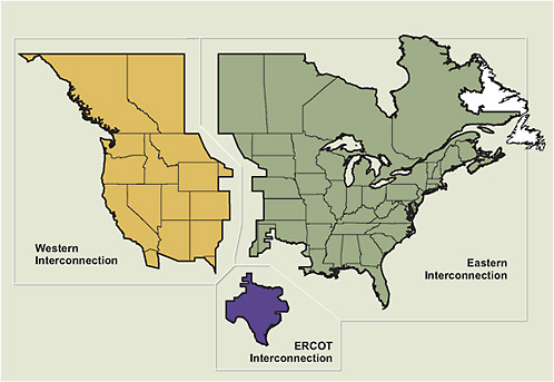

  13. fuzzy1
    17,851
    10,646
    I should clarify that the bulk of North America is on one of just three major grids. Jimbo is part of the Eastern Interconnection:
    (There are a few minor and many tiny grids just beyond the borders of this chart.)
    While his city has 70 MW of its own generators (if they are even fired up), everything in a region is interconnected and runs at the same frequency. For him to change the system frequency, his 6,000 W would have to push or pull the entire 600,000,000,000 W Eastern system. Ain't gonna be measurable.
    Because of local impedance matters, he would have greater impact on local voltage. But still negligible beyond just a few homes.
    Each Hawaiian island is its own grid, and they also have lots of solar installations, so they suffer some of the same issues as your small isolated grids, though not to the same degree. Alaska and Northern Canada have many very small isolated grids, but I don't know if they have enough solar to have much impact.
