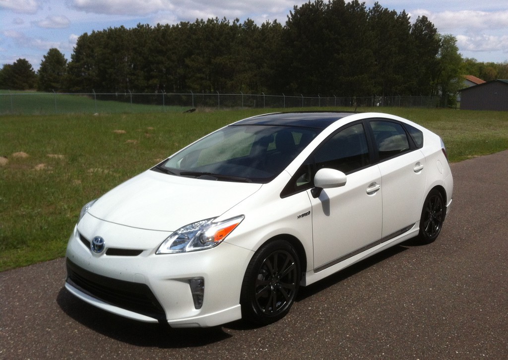

    It is capable of 22v at 3.6a if you want to do some mods to use it with a battery charge controller to charge batteries. One disadvantage is you may not like the additional attention your car gets as it looks way nicer with the solar roof verses not having it [​IMG]
    It also costs $3820 MSRP as an option on the Prius Four, but you get a host of other goodies bundled with that price so it's well worth it.
