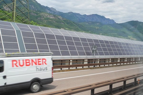

    What advantages will that have over putting them on rooftops?
    In snow country, a wind break is also a snow fence, creating deep snow drifts directly on the road. This is not a good thing.
    Some sound barrier walls could serve dual purpose as solar energy walls. Here is one I spotted in Italy several years ago: [​IMG]
