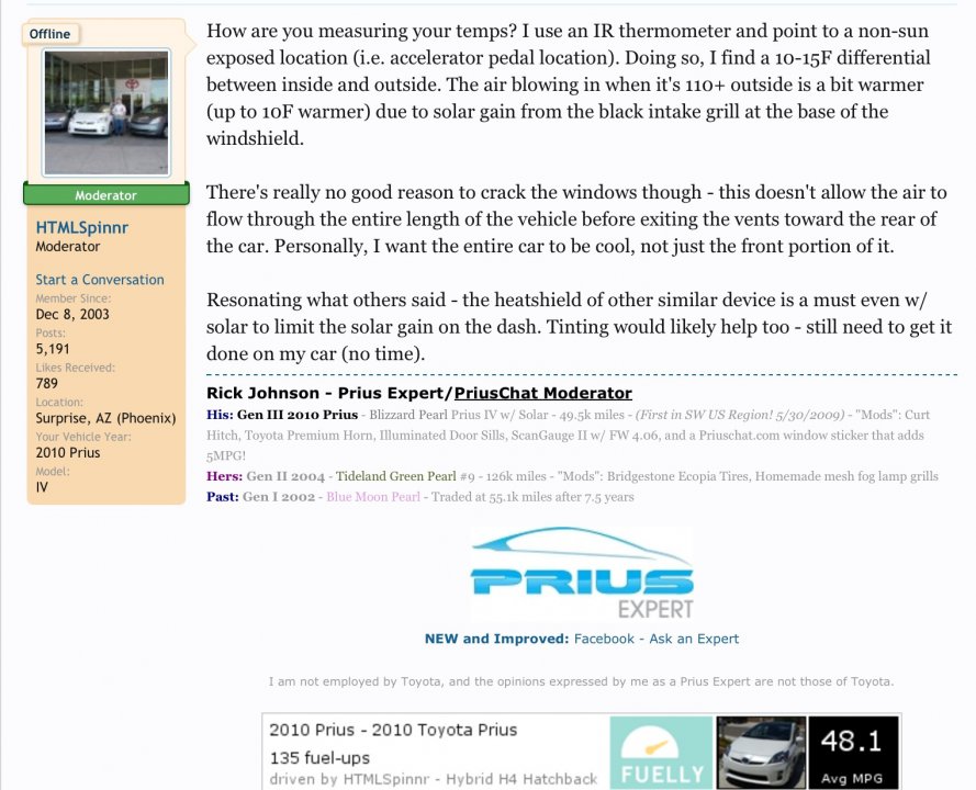

    A simple test is to take the temperature with and without the solar fan on on a Similar day on the rear seats.
    This moderator Who lives in Arizona noticed a 15 degrees lower temperature. Others in a old thread reported up to 25.
    Arizona can get brutal hot in the summer, where I live the temperature in the summer is high 70's but can reach 80's a few days a year
    2010 Solar Roof Temperature Report | PriusChat

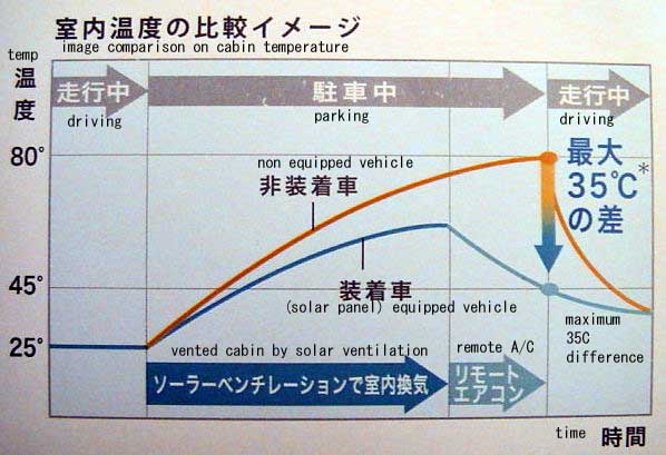

    Note that it includes Remote A/C in the 35°C calculation.
    JMD likes this.
