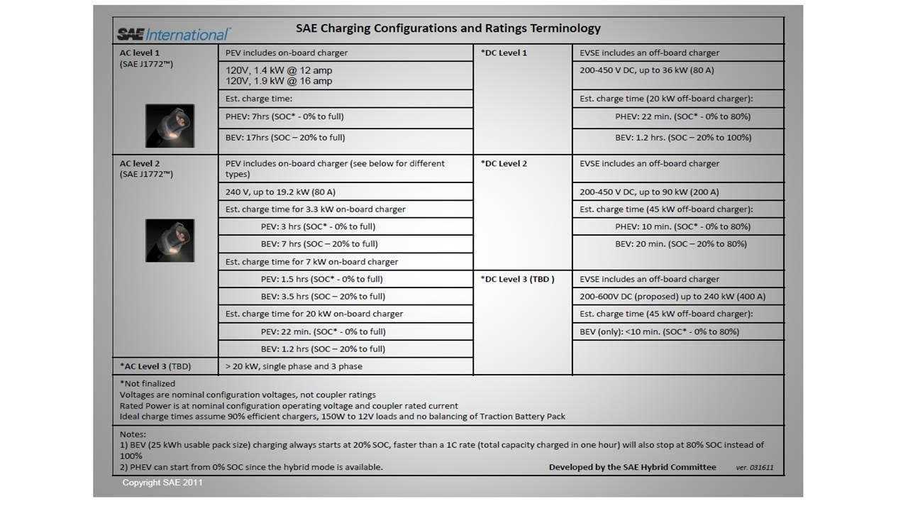

  10. Trollbait
    23,743
    12,832
    Yes.
    Public L2* chargers aren't actually chargers, they are just a physically oversized EVSE. It is car's onboard charger doing the charging. The public EVSE might limit that car's charger because of the limits of its electrical supply, or the owner charges by time, and wants to defraud EV owners with faster chargers.
    * I'm assuming this is AC. Officially, there is no longer a L3 by the SAE. It is AC L1, AC L2, DC L1, and DC L2.
    Solid state just refers to the battery not using a liquid(or gel or goo) electrolyte, not the type chemistry. The solid state batteries under development are Li-ion. So they aren't a solution for those worried about raw material supplies.

  12. Trollbait
    23,743
    12,832
    I think it came about because of the differences in how the charging is handled.
    With AC charging, the job is handled by the charger built into the car, and thus it becomes a limiting factor on charge rate.
    With DC, what people call the charger is truly charger. So the only limiter in the car is the battery itself.
    I don't think there is any DC L1 chargers in use within the US. Telsa's local Superchargers might be rated faster than the terms definition. China might have some. It may not be much faster than AC L1, but you get a wider selection of what charger to use when it is outside the car.

  17. Trollbait
    23,743
    12,832
    Electric Vehicle Charging Levels Explained
    I guess some of the CHAdeMO and CCS units out in the wild might only be DC Level 1.
    Superchargers now exceed DC Level 2 definitions. The very first ones might have been 70kW. The Urban Superchargers have a 72kW max.
    Tesla Supercharger - Wikipedia
