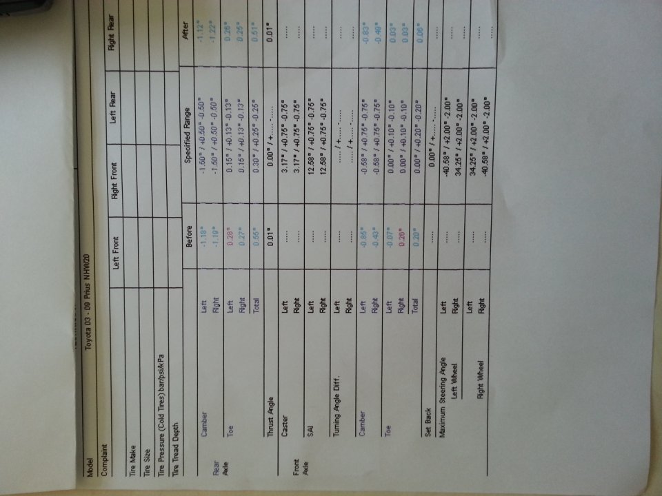

    Toyota has completed the recall, prior to the commencement of the works the tire pressure has been corrected and the newer tires were moved to the front.
    - alignment results attached.
    Finally after weeks the issue has been corrected, two new locknuts on the track rod ends were replaced.

    Achieved: The steering part has been replaced (I hope), the wheel alignment is same/ similar as before the recall, two brand new locknuts replaced the old ones.
    Can someone help to interpret whether discrepancy in left/right Camber would have significant effect on the tire wear?

    The camber at those figures will not cause any problems with tyre ware. To much camber can cause the tyres to ware on the inside edges.
