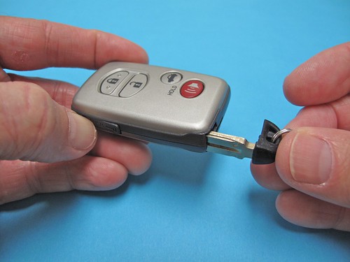

    Not the key. A spare (and mated) SKS fob.
    Inside the SKS fob is a keylet that unlocks the door, and some people attach that to a hidden exterior location.
    The reason?
    If for some reason your SKS gets lost or stolen, or you switch drivers and your co-pilot walks away with your SKS...etc, your G3 becomes, or will become a 3200 pound stationary object until it's reunited with a (mated) fob.

    Both fobs have a small removable metal key. This is used if your coin battery is dead on the fob, to unlock the door. Then you hold the fob up against the Start button, so the car can sense the fob's code without needing a working battery in the fob. (The car can energize the fob enough to work at this short distance, even with no battery in the fob.)
    So, you lost your ($300!) fob, and want to drive back home:
    Get your spare metal key from under the bumper or other hiding spot.
    Open the door with the key in the door's keyhole. But the car still won't start with just the metal key.
    Find the hidden fob inside the car. (Which has the battery removed, so it'll last more than a couple of years hidden away.)
    Hold the spare fob up to the Start button.
    Press Start.
    Drive!
