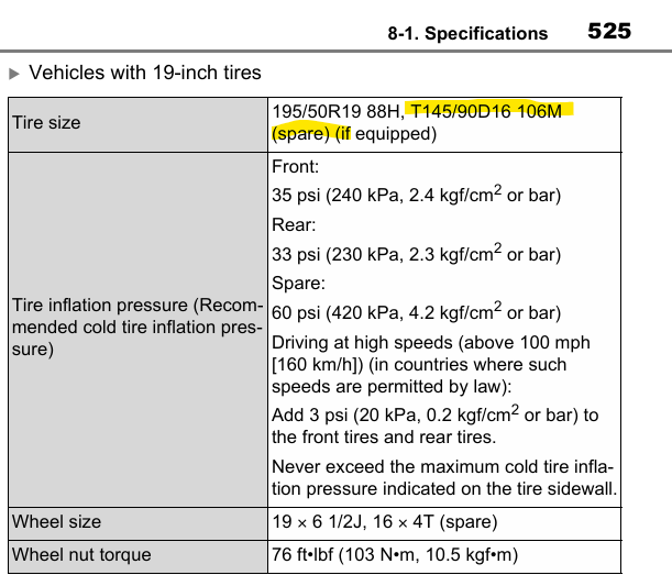

    Anyone with a 23-25 Prius who bought their own spare tire what size did you buy and did you have any storage issues?
  2. Mendel Leisk
    61,503
    42,320
    Temp spare info is in the Owner's Manual. You can also download a pdf here. Page 525:
    @Hammersmith has a definitive thread on this as well.

    wheel
    42611-OR271 Toyota 17x4 5x114.3 +10 Alloy Wheel
    Tire
    Continental sContact 115/95R17
    Currently mounted on Thule Caprock roof rack. Took up to much space inside the car.
