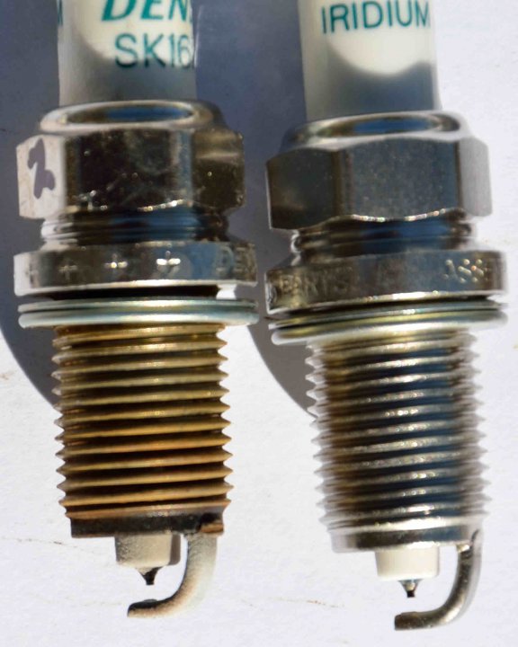

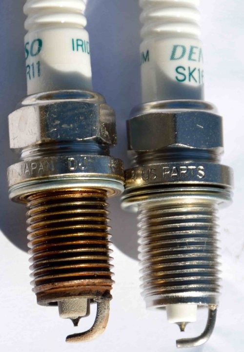

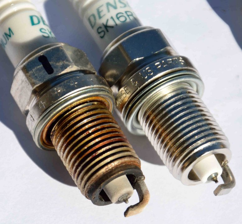

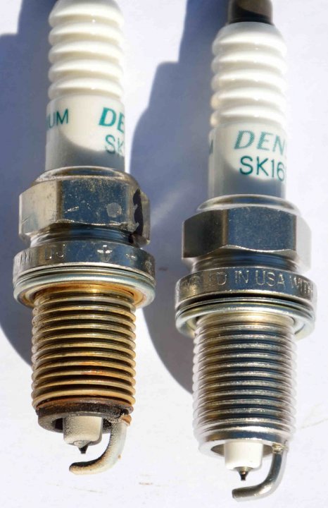

    Am I mistaken to believe, based on the pictures below, that the spark plugs could go a little bit longer than 120,000 miles? #1.JPG #2.JPG #3.JPG #4.JPG

    Still looks good to me. In fact I would wire brush them and put them back. I'm all about saving money!

    The used plugs look pretty good. However the answer to your question would be based upon the spark plug gap.
    The correct gap is 1.0 to 1.1 mm. If the gap is 1.2 mm or more, the plugs should be replaced. Do not adjust the gap of a used iridium spark plug.

    Yeah those plugs are in amazingly good condition given the number of miles. I recently changed mine for the first time at 200,000 km (124000 miles) and they looked very similar to yours. Very little wear. (y)

    There is so little wear on those plugs its unbelievable. I personally believe you could clean them up and be good for another 50-100k miles but others have disputed me on that.
    The old ones are made in Japan so they're likely better lol.

    Yeah, I'd toothbrush them with carb cleaner. Actually quite effective. Some plugs don't take kindly to wire brushing, or sand blast, and I think the long-life plugs are in this category.
    Still, after digging down to those, and with new spark plugs on hand, c'mon...

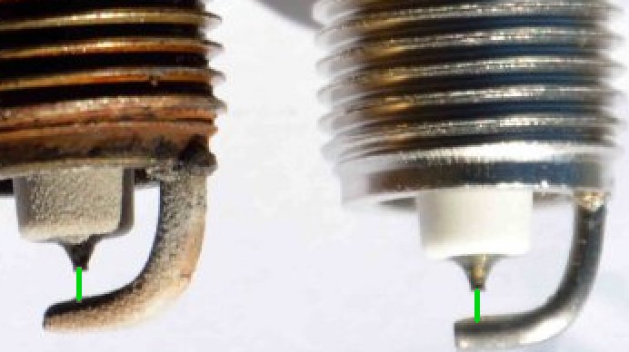

    I suspect the gap is too large.

    I'm sure it could go a bit longer. But, when the weakened ground electrode (as clearly visible in the image) or porcelain isolator breaks off, the engine will go kaput. Why risk it? Spark plugs are cheap.

    Here's a zoomed in view of OPs last photo. The green line is cut and pasted, so the same length on each plug. The gap of the old plug still looks fine.
    Also, there's still loads of wear remaining on that ground electrode. I suspect that these plugs could run another 120,000 miles and have nothing fall apart. Still I agree with Jacek though, with the relatively low cost of a new set of plugs there's no point in risking it.

    1. The gap of the used plugs was still in spec. Using a craftsman 6 leaf spark plug feeler gauge, the 1.02mm spark plug feeler gauge cleared the gap. The 1.14mm gauge did not.
