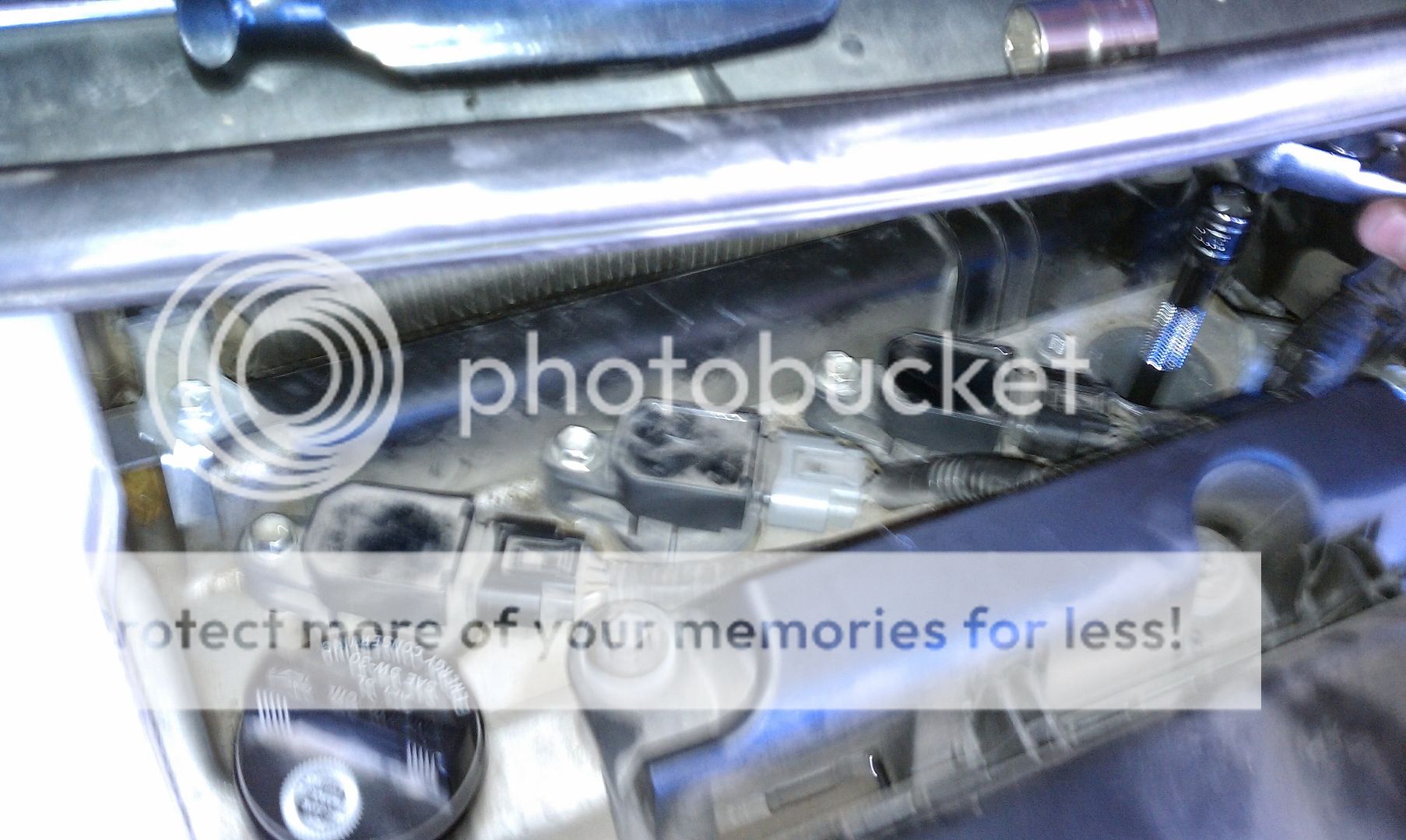

    Adding my 2 cents..... I just changed mine after 145K.
    The old plugs really didn't look worn... however I think it runs smoother when idleing although I had no real complaints before.
    I apologize for the blurry picture... holding the wrench with my right hand and taking the picture with my left hand on my phone doesn't work so hot.
    Take a 3/8 wrench and a sparkplug wrench.. while some use magnetic, mine had the rubber insert that held the plug quite excellent.
    Remove the fusebox from the firewall.. 2 simple screws and it swings out of the way.
    Take the small screw off the spark plug cap over the plug... once thats off the whole assembly lifts right out..... I did have to purchase a 6 inch extension as my 10" wouldn't work as it was too long... I think 8" would be too long also.

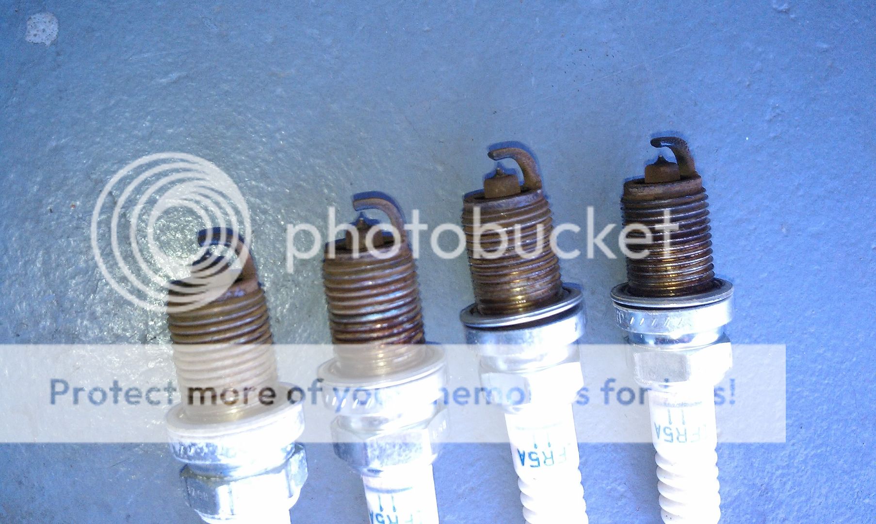

    The first 3 are pretty easy... I took one out and replaced with new before moving to the next so as to avoid any mixups.
    All 4 of my plugs were a nice toasty brown... not sure the difference between mine and the white ones in the previous pictures on this thread.... I use 87 octane and drive pretty aggressive "so does my wife" and thats what I got.
    I did put anti-seize compound on the threads before replacing... very good idea since its so long between changes.
    The last one to the extreme right was a little harder but not bad.
    I had to remove the electrical connection because there was not enough slack to lift the whole thing out.
    Take a look at the others to see how they lock because the view is a little crummy for the last one.
    I pushed on the release with a small screwdriver with my right hand and wiggled it with my left....
    I recommend when replacing to "not" bolt down before hooking the electrical connection so you have a better flexibility on getting the new connection back on so you can manipulate the angle as needed.
    I didn't torque.. just a good respectable snug tightening with the wrench but didn't go crazy.
