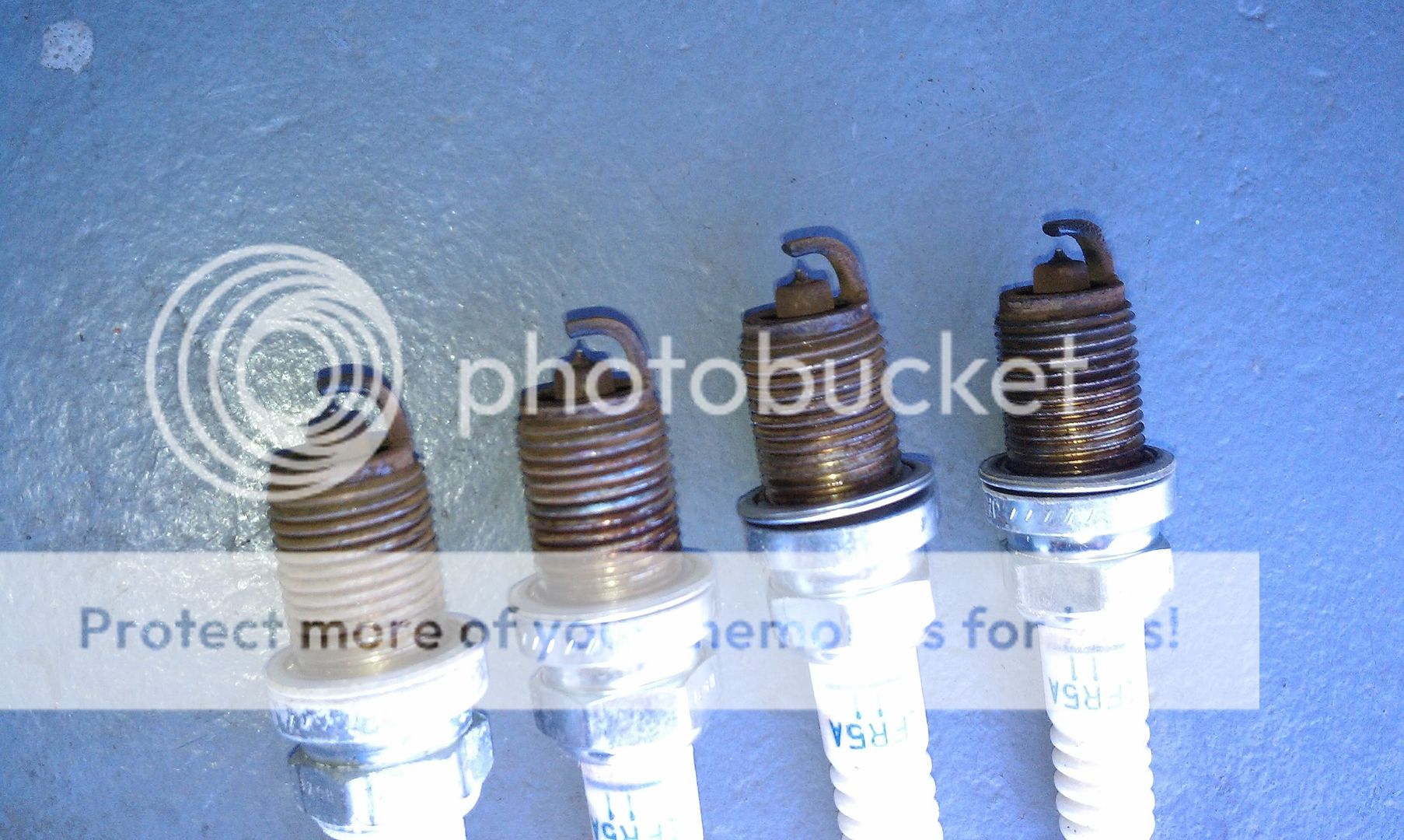

    I just finished changing my plugs; thanks to all who have contributed to the knowledge base. I didn't have a spark plug socket, and wound up using a 5/8 deep socket, a magnet to get the old plug out, and a 6" piece of 1/4" ID vinyl tubing to get the new plug in. Slicker'n snot -- much easier, I think, than trying to maneuver the spark plug and socket as a unit in the confined space. Here's a picture (I hope) of one of the old plugs, after 96,053 miles. They all looked about the same, and their gaps were just at or above the high limit.

    I was doing some other maintenance on my 2007 Prius with 120K miles on it and thought I'd look at the spark plugs while I was at it. My plugs don't look as bad as some of the pictures posted here but I'm wondering if someone can tell me whether I should go ahead and replace them.
    Thanks.
  6. mfa-prius
    mfa-prius Old member
    Jun 4, 2005
    299
    46
    Hansville, WA
    Sure. Go ahead and replace them.

    If the plugs don't look terrible, then the issue becomes whether the spark plug gap is within spec, 1 to 1.1 mm. Certainly after 120K miles the plugs can be replaced.

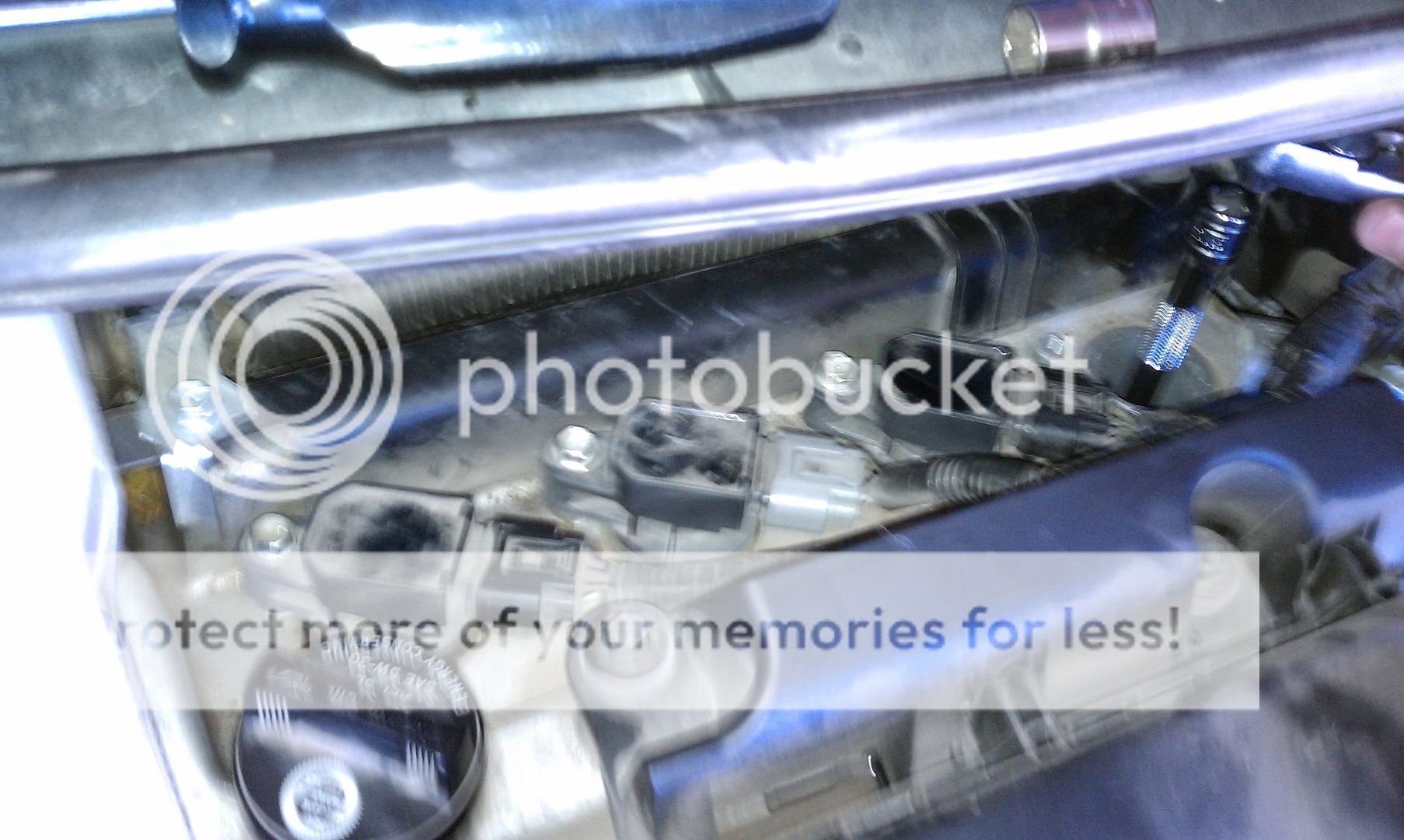

    OK, I will go ahead and replace them once I decode the instructions to unclip the wires from the ignitor on the rightmost spark plug.

    If you take a look at the wiring harness connector, you will see that there is a lock which holds the connector in place. Use a small flat-blade screwdriver to gently lift the lock up, then you can pull the connector off the ignitor.
