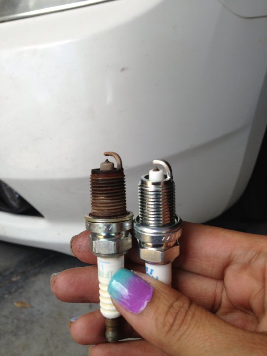

    I just did it this morning. These are my spark plugs after 136,000 miles. image.jpg image.jpg

    Wow, it's amazing how little wear the electrodes on those iridium plugs show after all those miles. I've got my new plugs here ready to go in next time I give it a service, just gotta wait for a nice warm day to do it.
    BTW. I'm impressed that you got them changed out without breaking a nail. :cool:

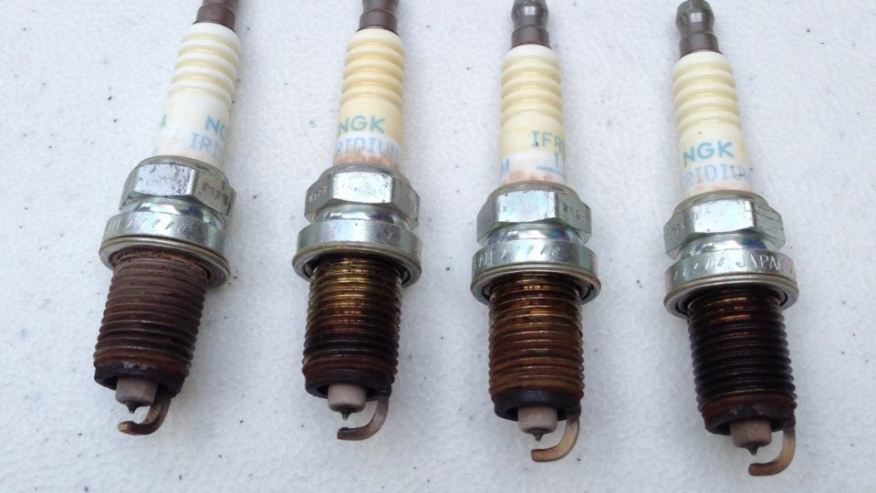

    Thanks to all who posted pics and advise. Waited a little longer than most. Just changed mine on the '08, at 222,800 miles. Plugs looked pretty worn. Test run was a success, now for another 70,000 then I'll do it again.

    I'd love to see a picture of those "pretty worn" plugs.

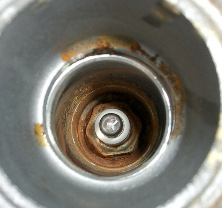

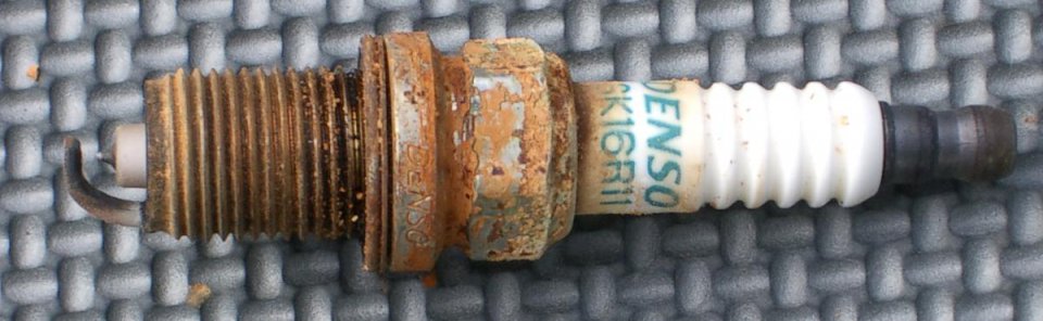

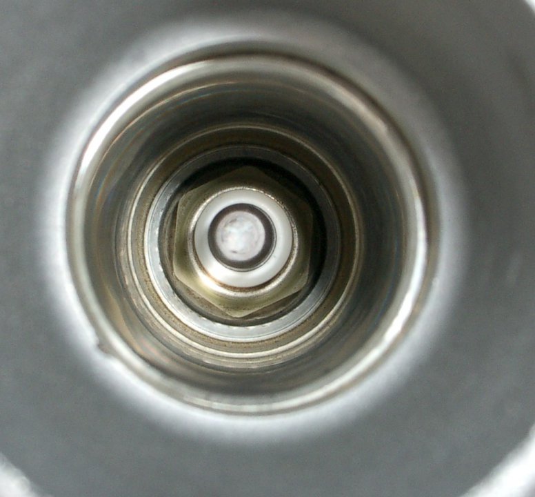

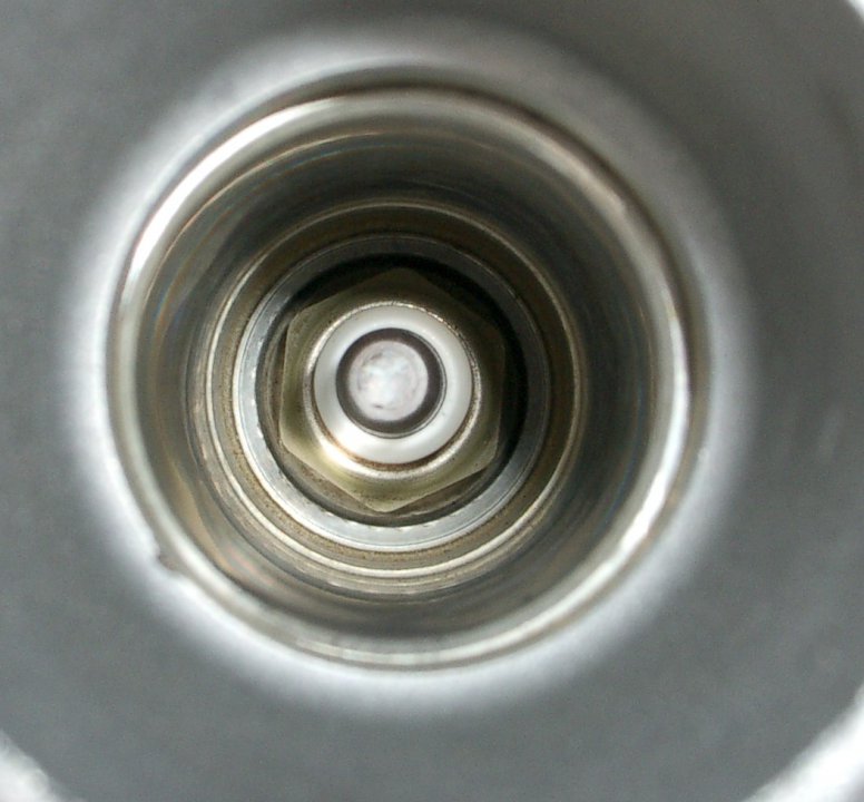

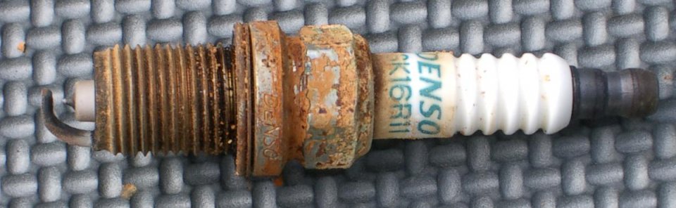

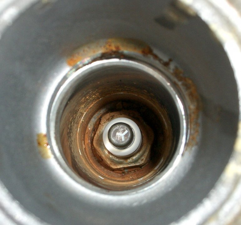

    Just changed one of mine, '05 with 68k on it. I removed the wiper cowling and pan, changed the PCV valve, cleaned the wiper drain pan (good thing, as the two drains in the bottom were totally plugged), and inspected the plugs and ignitors. The '05 has the defect TSB where the wiper cowling leaks onto the engine. The rightmost plug was all rusty so I replaced it. The other ones seemed fine.
    The bad plug once removed:
    I suggest that if you see the plugs are rusty, try to get the debris out before removing the plug. I vacuumed before removing the plug, but a lot more rust was broken free when I removed the plug and fell into the cylinder. I think it would be better to loosen the plug a few turns, vacuum around it, and then remove it the rest of the way.

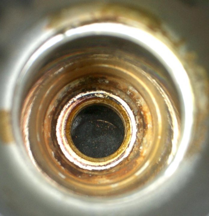

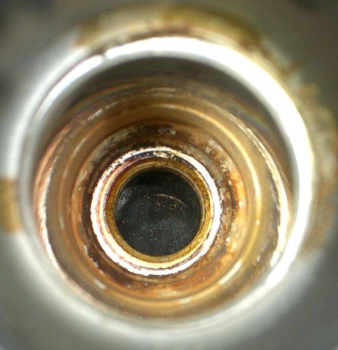

    I think I got most of the debris out of the cylinder by taping a small rare-earth magnet to the end of a long 1/4" socket extension that would fit down through the hole into the cylinder.
    If your spark plug socket has a rubber ring to hold the plug in place, make sure it's still in the socket when you're done and not still on the plug.
