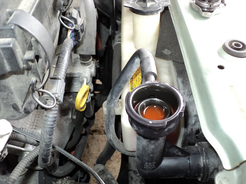

    Finally, keep an eye on the fluid level in the radiator after you refill it. Sometimes it will drop down some and not take any fluid from the overflow bottle. The level should be even with the top of the neck underneath the cap. Check it when the system is COLD.

    Once the radiator starts looking like the picture I posted above, you should be OK. Just keep an eye on it for a few days until you see it is consistently NOT dropping in the fluid level in the radiator. I am pretty sure the pic is the correct level when the system is full. Otherwise I would not have posted it here on Prius Chat.

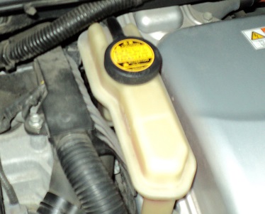

    Ask them are they going to change the fluid for the inverter? And point at the inverter bottle under the hood. It is the narrow rectangular bottle that sits on top of the engine next to the inverter.
    If they say NO, then STOP before any work is done.
    I say this because the transaxle is cooled by the inverter pump but also has its own separate transaxle fluid also. The inverter and radiator takes the Toyota SLLC whereas the transaxle takes a fluid similar to tranny fluid. I can't recall the exact name. Patrick Wong can tell you that.
    The inverter bottle is pictured below.
