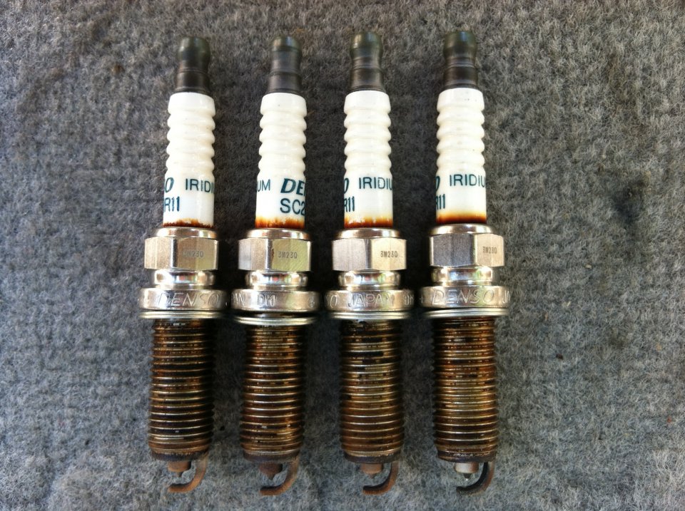

    How are the plugs looking when you take them out?

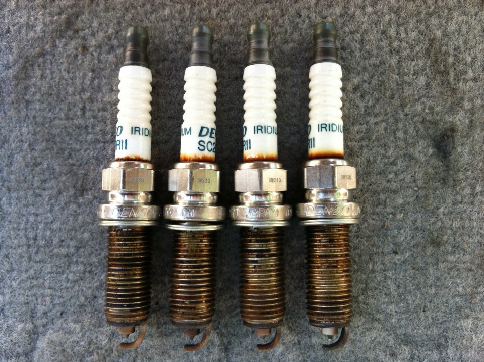

    Thank you again. Did it today, and it was easier and took a lot less time than I thought. Thanks to the video, I knew exactly what to expect. Mileage: 129250

    Not bad. Could have gone another 100K. :D

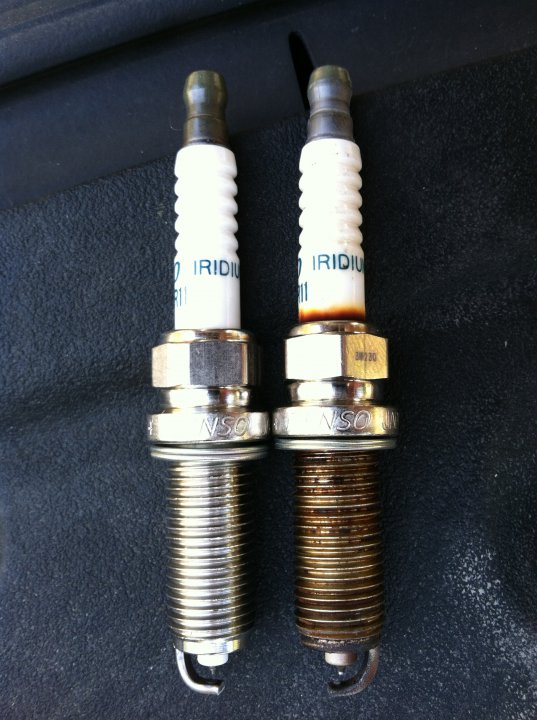

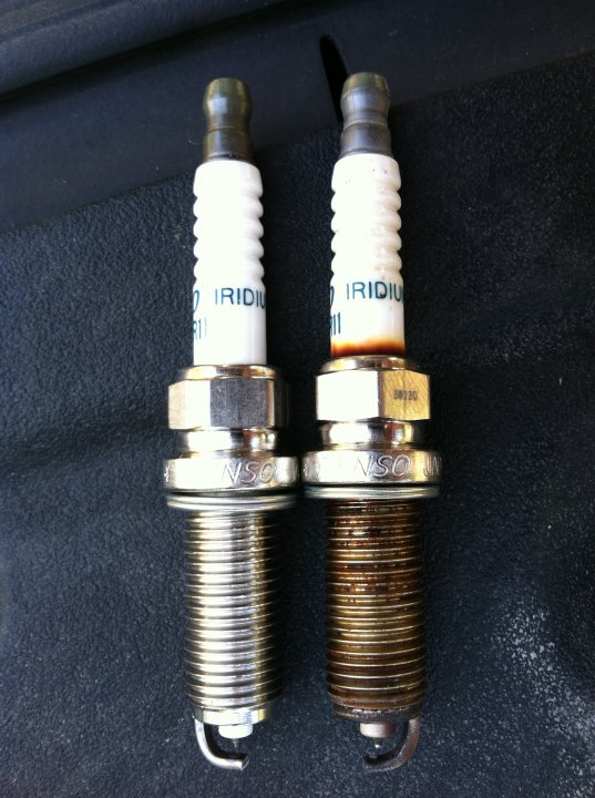

    did mine ...163k one side of plugs looked sooty with buildup and one side looked clean. similar to yours, a good thing I guess.Looks like the iridium tips looked worn but did their job well. no oil on plugs so i'M GLAD for that. pretty dry plugs. It was very easy. I used a battery drill on screws and everything was Cake! 35 minutes start to finish. nothing scary and well worth the $ saved at dealership.. I really want to visit some basic EGR pipe cleaning...
