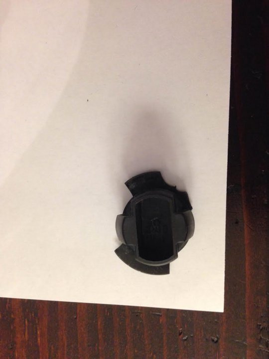

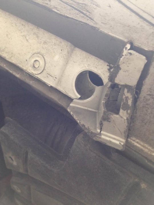

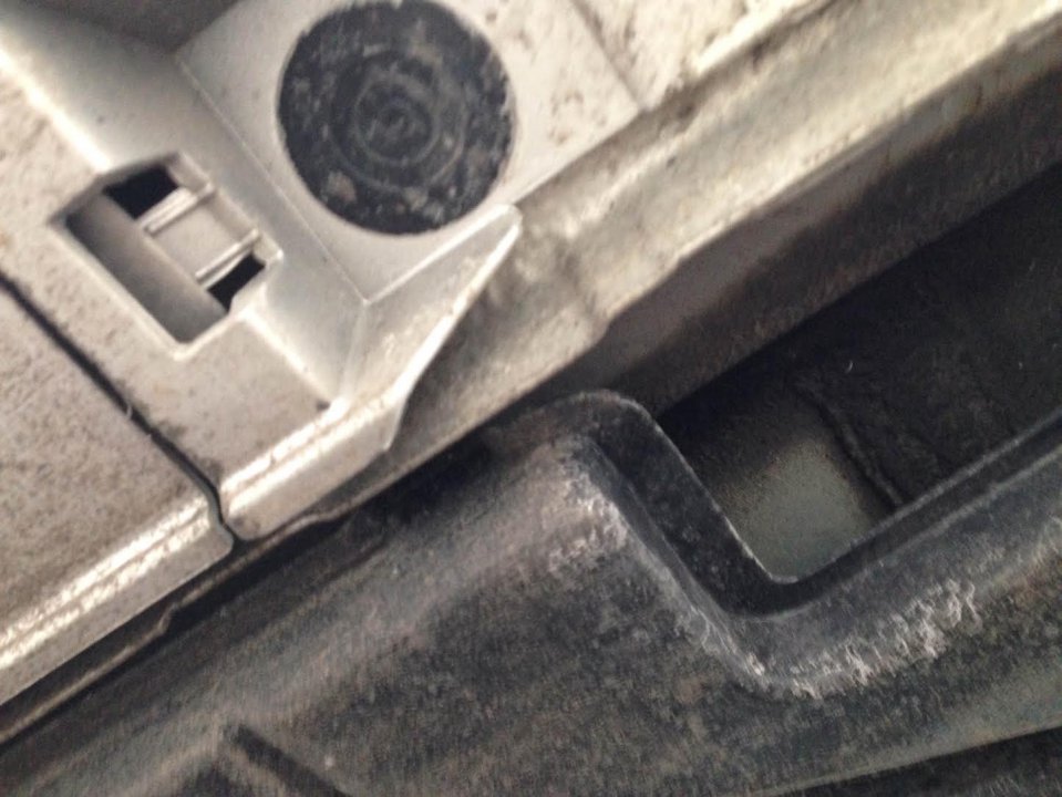

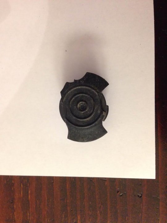

    I already had a thread going for this particular damage, but after further investigation under the car i managed to take better pictures and find out exactly what i need to fix this. I need your help in identifying the black plastic rivet I need to order for this particular situation. Attached pictures has the damaged right side of the Rocker, a pic from the good left side as well as a shot of the broken plastic rivet. Any help identifying the part number or proper name would be greatly appreciated.

    I remember have lost a couple of these that wiggled out of my rocker panel covers.
    I used a couple of 7/8 inch or 22mm Heyco nylon hole plugs designed to close out open 1/2 inch nominal knock outs for electrical boxes like these on eBay.
    Most large Hardware stores will have them. I got mine at Home Depot.
    The "teeth" on these reach deeper and hold better than the originals.
    I put mine on about 6 months, ago. I just went out and checked them, and they are still in place holding tight.
