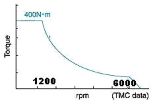

    The spec you quote is the same that I find in the 2004 New Car Features manual on page TH-27, and what it really shows is that the torque behavior of the motor is pretty darned simple:
    it's a straight line at 295 lb-ft (400 Nm) all the way from zero out to 1200 RPM. Right at 1200 RPM, it changes to a decreasing concave-up curve (the same shape as a y = k/x curve), right on until the limiting RPM for the motor, where it goes to nothing.
    I got that image from L. David Roper's Physics of the 2005 Prius page, but it's recognizably the graph on page TH-28 of the NCF with numbers overlaid for clarity.
    So why that sudden change from constant torque to decreasing torque at 1200 RPM (about 21 MPH, for gen 2)?
    Well, the specs on page TH-27 also say MG2 is a 50 kilowatt motor. 1200 RPM is the very spot where 400 Nm of torque and 1200 RPM work out to 50 kW.
    Below that speed, even at the maximum torque, the motor is at less than max power, so you get the max torque.
    Above that speed, you can't have the max torque, because that would exceed the motor's power spec. Instead, you just slide down the y = k/x curve, the locus of all points where the RPM times torque works out to the 50 kW max power.

    Minor edits of the torque curve to show what a 0.5x second gear could achieve:

    That edit shows both a torque increase as well as an RPM increase at the same time.
    Yeah, no. I'm not buying that a transmission adds power to a mechanical system, (Unless there's another motor involved in the transmission.)
    Whatever you've added to the Torque, you've gotta remove from the RPM, or vice versa.

  14. ChapmanF
    28,654
    18,969
    Yeah, looks like any point on that added curve is both above and right of the original, so will have torque ✕ RPM coming out to more than 50 kilowatts.
    Where's that power going to come from?

    I took the original torque-rpm line and cut the vertical height in half, 0.5x, to reflect the reduced torque of a speculated gear change. Then I anchored the 'shift point' where the slope of the reduced torque reached about -1. So the graph show the primary effects of a 2-speed gear I would design. I've also ignored the time to slow the motor down and brief interval of clutching to change the gear ratio.
    Feel free to propose another curve.

    Is it not the case that all the points of your added curve are both above and right of the original curve, and therefore have coordinates whose product exceeds 50 kW?
    How should that be explained?
  20. fuzzy1
    17,900
    10,689
    You increased total motor power output, without actually increasing its power capacity. A violation of Conservation of Energy.
    Convert that chart to torque vs RPM at some other point, e.g. wheels. For Gear 1, the shape would be the same, just the axes scaled different.
    For Gear 2, the torque cap is cut in half, RPM of the upper corner is doubled. At the right-hand end, the same k/x curve is continued out to twice the red-line RPM of the G1 curve. I.e. similar to having the same power motor without reduction gear, but doubling its red-line RPM.
    In the operating range between the corner where Gear 2 changes from torque-limited to constant power, to where Gear 1 hits its red-line max RPM, they share the very same power curve.
