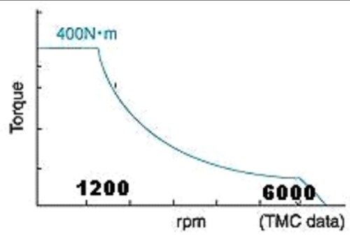

    I added the graph to explain how a 2-gear transmission would work with an electric motor:
    Not as long as:
    Horsepower = Torque x R.P.M. / 5252​
    The chart Y-axis is torque and the X-axis is rpm. So I reduced the original curve height by half which is what the second gear would do. The relative rpm, the X-axis remains the same but the displacement shows power continue beyond the single stage gearing. The second gear cuts the torque in half but doubles the ultimate rpm. So the car continues to pull beyond where the single gear would fade out.

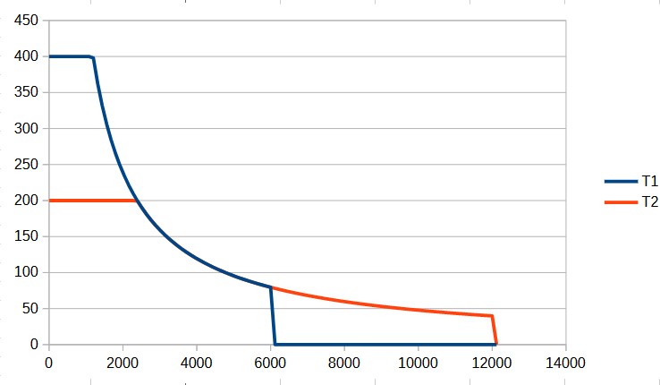

    The motor's Torque-RPM graph shouldn't change at all, with or without the second gear.
    That is why we need to pick a second reference point, downstream from the gear change transmission. One possible choice is at the wheels. Or, pick the transmission's output shaft itself. Assuming the later, with 1st gear being a simple straight through, while 2nd gear is a 2X overdrive, I get this:
    X-axis in RPM, Y-axis as torque in N*m.
    Is this a more reasonable explanation? It cuts low speed torque in half, but enables a higher potential speed. But for any given speed that isn't either torque- or RPM-limited, the power output is the same.

  12. fuzzy1
    17,900
    10,690
    ^ What is it's output-shaft or wheel-axle torque vs RPM graph? Each gear, superimposed on the same chart?
    Does it resemble my graph in post #29?
    Isaac Zachary likes this.

  19. fuzzy1
    17,900
    10,690
    This isn't a traditional DC motor.
    Constant power curve added:
    Both gears' torque vs RPM curves made more visible across entire range.
    #39 fuzzy1, Apr 27, 2024
