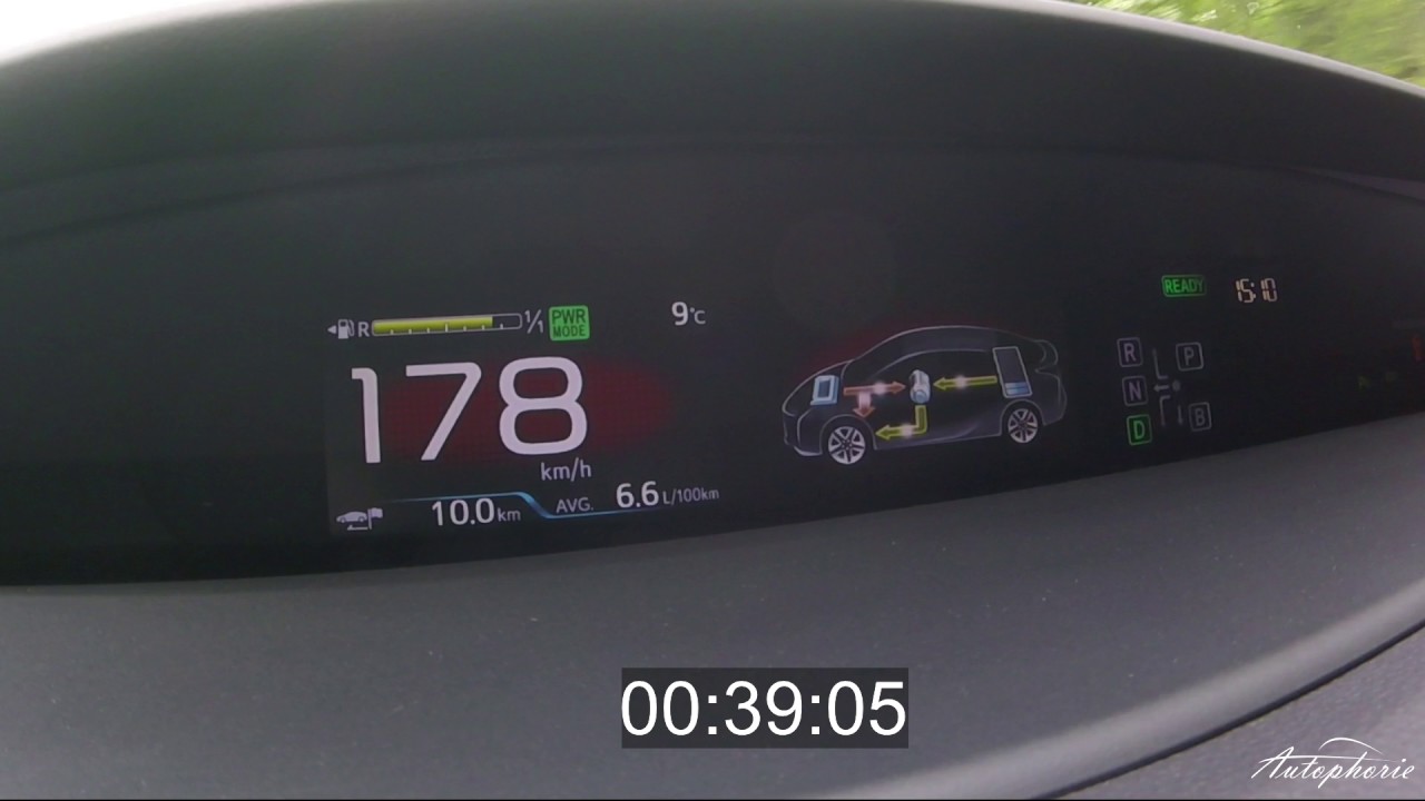

    There is a speed limit for the Prius which is the same for almost all Japanese built vehicles in the past few decades of 180kph. That's roughly 112mph. The car will not allow you to accelerate more than that, but it will continue to show your speed accurately if you are on a sufficiently steep downgrade that you could still accumulate speed while overcoming the air drag. It won't slow you down, it will only limit you from going any faster.
    Some vehicles are different like the Nissan Leaf which is speed limited to roughly 150kph (94mph) and when you hit the limit the accelerator pedal stops responding to input until all pressure is released and then re-applied. So a "stuck" pedal would get the car up to 94mph and then it would coast to a stop with no user input. This is different than a Toyota which will go to speed and then stay there until the energy source is depleted.
    Even true on the new 2017's
