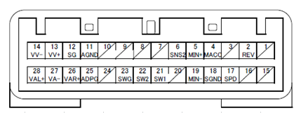

    L38 Pins Used for Nav Lockout Bypasss (2014 and older/2015 and newer, colour change only)
    • SPD 17 (L)
    • SWG 23 (P)/(W-B)
    • SW2 22 (SB)
    • Ignition Power (10 Amp) 1 (B)
    Digispark Connections
    • Tap into SWG (ground), SW2 (steering wheel "On hook" switch), Ignition Power
    • Interrupt SPD
    Vin (12v) = Ignition Power
    Gnd=SWG
    P2=SW2
    P0=SPD from Car
    P1=SPD to head unit
    Once installed, test the system by entering the setup screen on the head unit: With the car on, hold down the SETUP button on the head unit, and click your parking lights on and off three times. Go to the screen showing the Speed and after activation of your bypass look for something 2 km/hr or less. You can enter and exit this mode at any time by repeating the sequence.

    L38 connector- Note that Pin 1is marked by a small dot on the plastic

    I have all the parts, including the AutoHarnessHouse harness:
    Can anyone help me with the Toyota wire color indicators?
    From Mr. Zap's post:
    SPD 17 (L) - I assume SPD is Speed; where (L) is what color?
    SWG 23 (P)/(W-B) - SWG Signal Wire Ground? Color (P) == pink? with (W/B) white & black stripe?
    SW2 22 (SB) - SW2 Signal Wire #2?; where (SB) is what color?
    Ignition Power (10 Amp) 1 (B) - Pin 1 is black, I can verify which corner is Pin 1 using a multi-meter.​
  18. gromittoo
    gromittoo Active Member
    Mar 9, 2017
    719
    288
    philadelphia
    2013 Prius v wagon
    I found a PDF I had that explains two of the colors for me:
    P == Pink
    SB == Light Blue ("Sky Blue"?)
    Still don't know what color "L" is, and that is the wire that requires cutting.
    The PDF also verifies SWG and SW2.
  19. ChapmanF
    28,725
    19,025
    Why, bLue, of course (Black was already taken). :)
