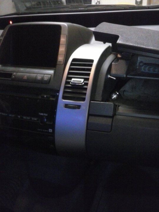

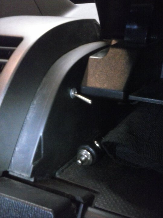

    Wow, the time it took to take apart, reverse engineer, and make that circuit for the automatic phone + navi hack....serious skillz Brosnan. As for me, I didn't want to have to solder together my own apollo lander to do it, so I hid the 1/4" DPDT switch inside the upper glove box. It takes a little reach to get to it from the driver seat, but it's not too bad. I wanted something discrete, but accessible at the same time. CAM00095.jpg CAM00096.jpg
